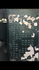

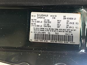

So I got my build sheet and also my plaque was also listed as DGB, does this mean I have some other mystery set up or beefed up trans internals? Just want to have all my ducks in a row

Posts: 87,479
Right on the first page of the build sheet: 4 speed automatic 46RE trans.
Yeah I saw that, just didn't know if the internals changed from 5500lbs package to 6600lbs package.
Old Feb 4, 2018 | 06:16 PM
Posts: 87,479
Nope, all the same.
