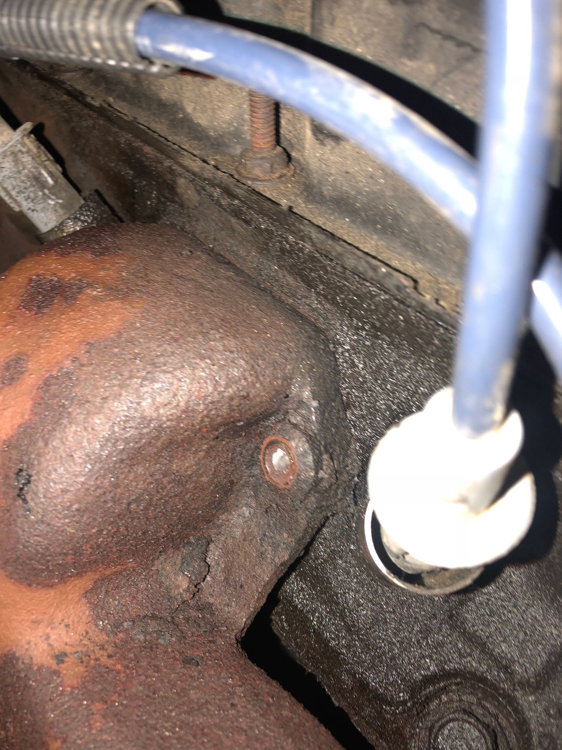

If the bolts break, you can still pull the manifold off. Then just clean them good with a wire brush, hit 'em with some chems, and take them out with vice grips. (or, if you have a welder, weld a nut onto the stud.)

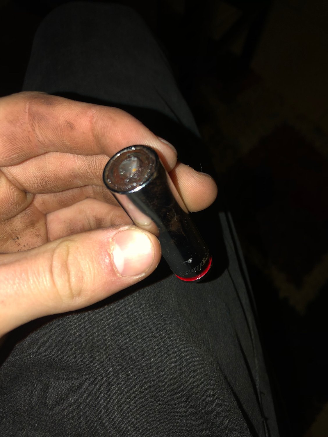

For bolts stuck in sockets, I usually just bounce them off the concrete a couple times, and they come out. Or stick a punch up thru them, and bounce 'em on the floor. Worst case, screw the bolt back into the hole, so the socket comes loose, then take 'em out again.

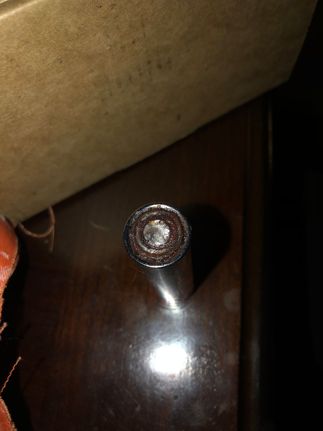

Update: Broke all four studs clean off, I'll upload a picture of what they look like now, but it looks like the base of the nut is still on the threads, so I'm not sure how to remove those. I've got a buddy coming to help me on Monday and he's got most of the tools I'd need to get this finished up. Got those broken studs out of the sockets, thank you for the advice on that, saved me another $12.. Next post I'll post a picture of the bolts that are snapped, they're all the same, and the only thing left after those is getting the flange free I believe.
Again, thank you for all the help.

heres that snapped stud

I'm guessin' your lookin' to do this stuff as cheap as possible? Do you have or can you get your hands on an air or electric hammer? They're great for getting rid of variegated rust and loosening old bolts. BTW, get some penetrating oil and soak that socket AND, if you got a proper sized phillips screwdriver, stick it thru the other end of the socket n pound her outta there. An old bolt of the appropriate dimensions will do as well. But I digress, also consider getting a map gas torch for stubborn bolts like this, heat soak those puppies (steer well clear of plastic, electric AND gas related stuff), especially when they love the spot they're in a little too much.

oh yeah next time you have a tight manifold nut like that use a little heat, saves a lot of heartache.
