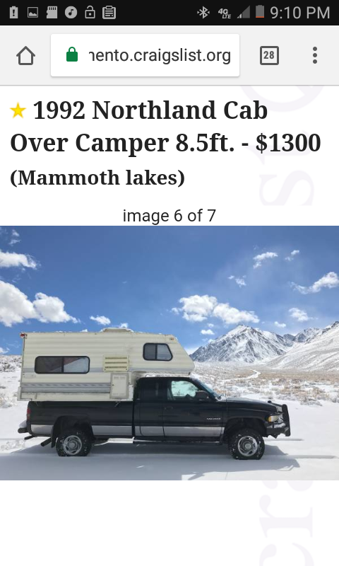

honestly your truck looks like its handling the camper pretty well from what the pictures show. maybe just some new springs for some reasurance?
ha, nevermind....just saw its not the same truck

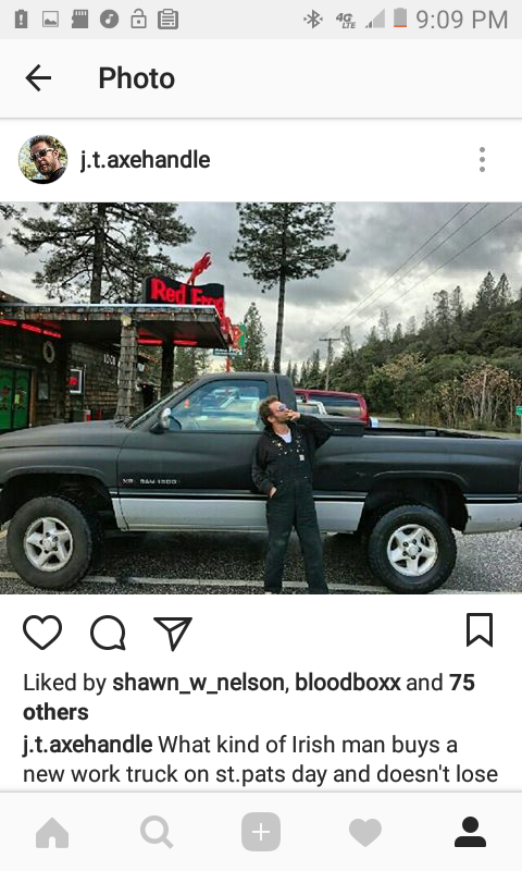

If that's your truck in the first pic, then your reg cab truck has a payload of 1720 so you could just throw in an AAL and probably be fine. I've seen plenty of 1500s with campers and there's different spring packs from the factory. Mine was 3 leaf, most were 4 while some were 5.
But that camper is too long for your short box anyway so. . .
