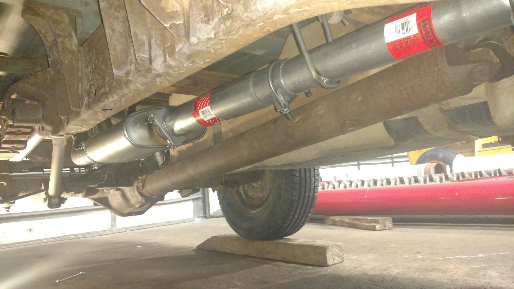

It's a Walker system, but the muffler says Dynomax. It's probably going to have a Magnaflow muffler on it shortly. I don't care for the sound of Flowmaster mufflers. It did fit well, except the truck has a ball for a goose neck, and the driver side pipe hit the bracket for it. The truck sure runs better now that it isn't constipated anymore. My truck didn't turn the check engine light on even with the transducer melted.

And here it is fixed. New EGR valve and transducer, O2 sensor, cat, exhaust system, and fixed a vacuum leak.
