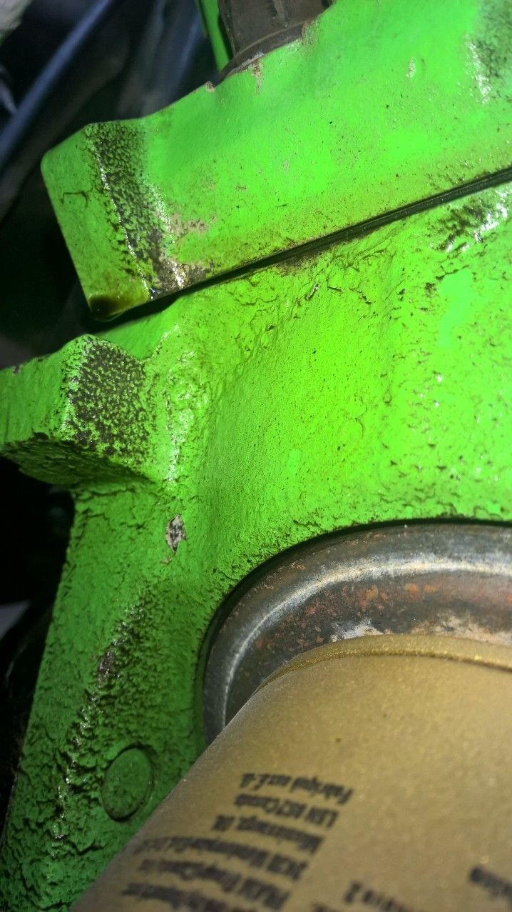

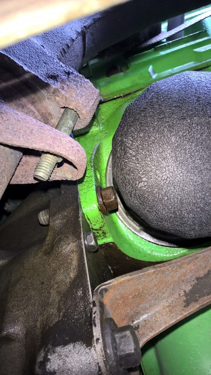

Got some pictures of that cylinder head leak. The first one is pretty good as you can see a drop of oil hanging there. above the cylinder head gasket it is perfectly clean so not coming from the valve cover. I did the paper towel test on the intake, definitely sucking it in. I looked down the intake again and yeah there was some good oil streaks in there this time. I'm thinking that I had a defective gasket. If you are familiar with felpro gaskets they often come with blue lines in the black material. I do not know what it is but I remember my plenum gasket in my rebuild kit had raised blue ridges rather than the flat ones (also felpro) that came with the hughes engine aluminum plate. I didn't think much of it at the time but pretty sure those raised blue parts are not getting compressed enough to make a good seal. Going forward I am going to get the hughes engine air-gap intake with no plenum. As for the cylinder head gasket, probably should just replace that right or do you think it will stop if the cylinder isn't getting oil in it anymore?

It looks like it's blowing back from the front or leaking down the back side of the head. I would retorque the heads and try to see if the back of the intake is leaking. Spray them with brake cleaner and see what happens. The leaking plenum has nothing to do with the external leak. Pull the PCV valve out of the valve cover and try the paper towel again.
