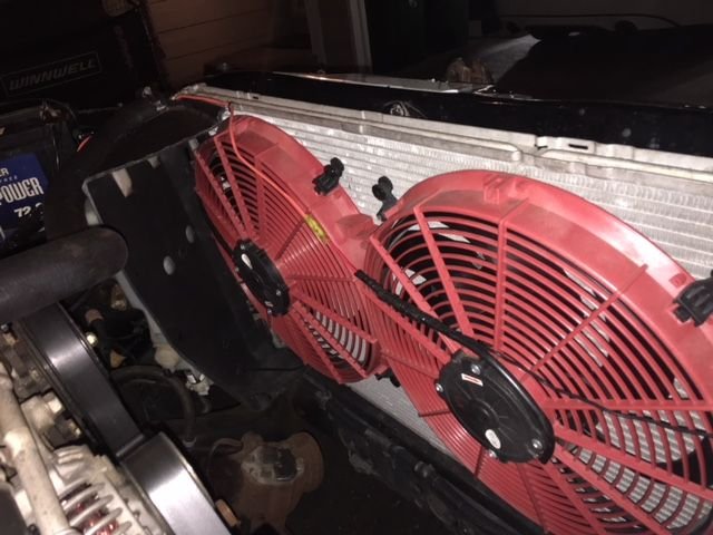

43) Possibly a bigger alternator (due to e-fan conversion) This was more of a concern before changing the blower motor. Prior to that, the blower would slow down when the e-fans would kick in. The new blower seems to have almost completely resolved that. (the blower slows a little every once in a while still but not like before)
