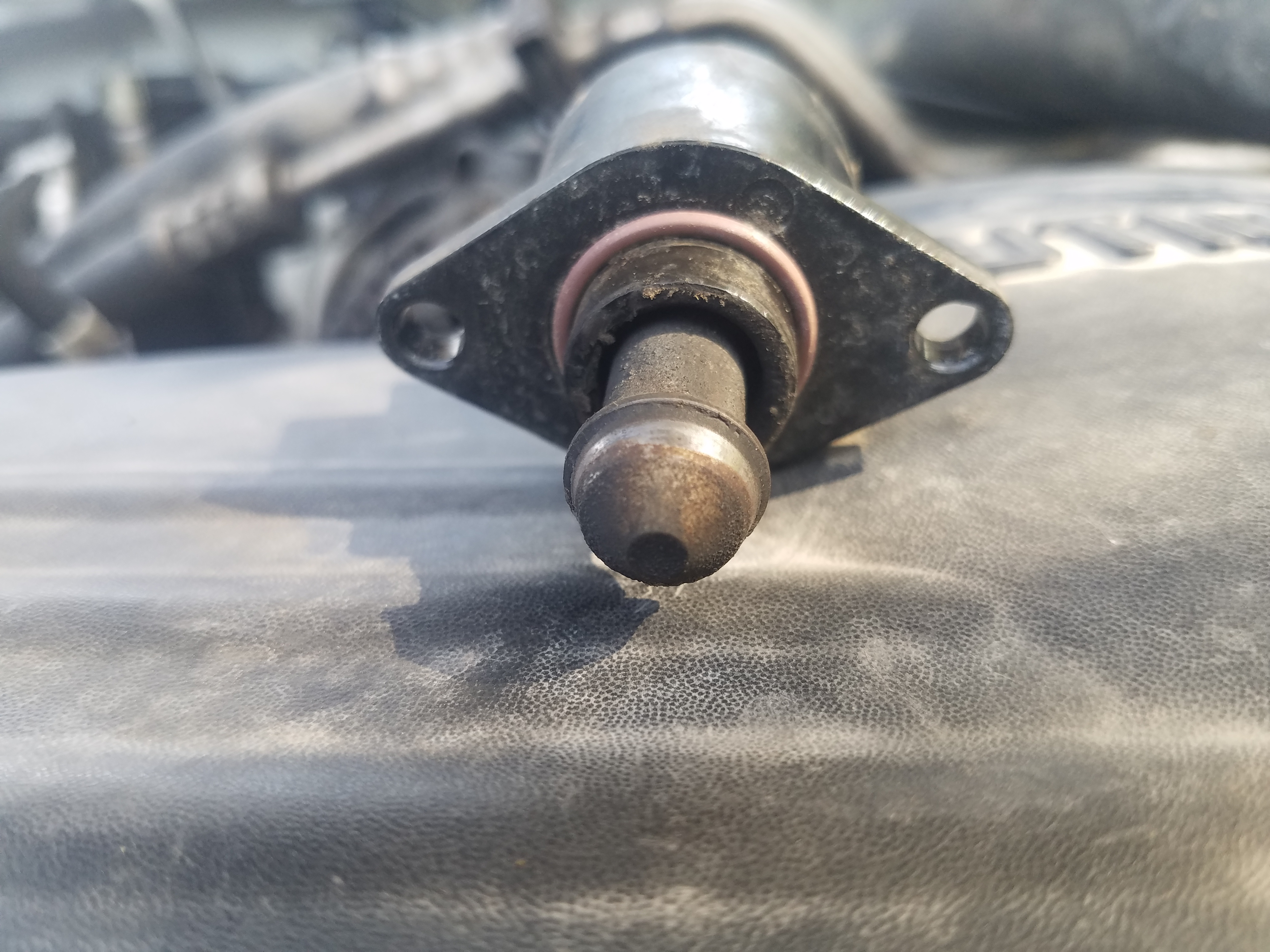

Checked it and it looks vacuumed in alot a bit also checked the iac and the end is covered with build up.
Attached Thumbnails Full throttle, barely any acceleration.. help?!?-15276357506482099331270.jpg
