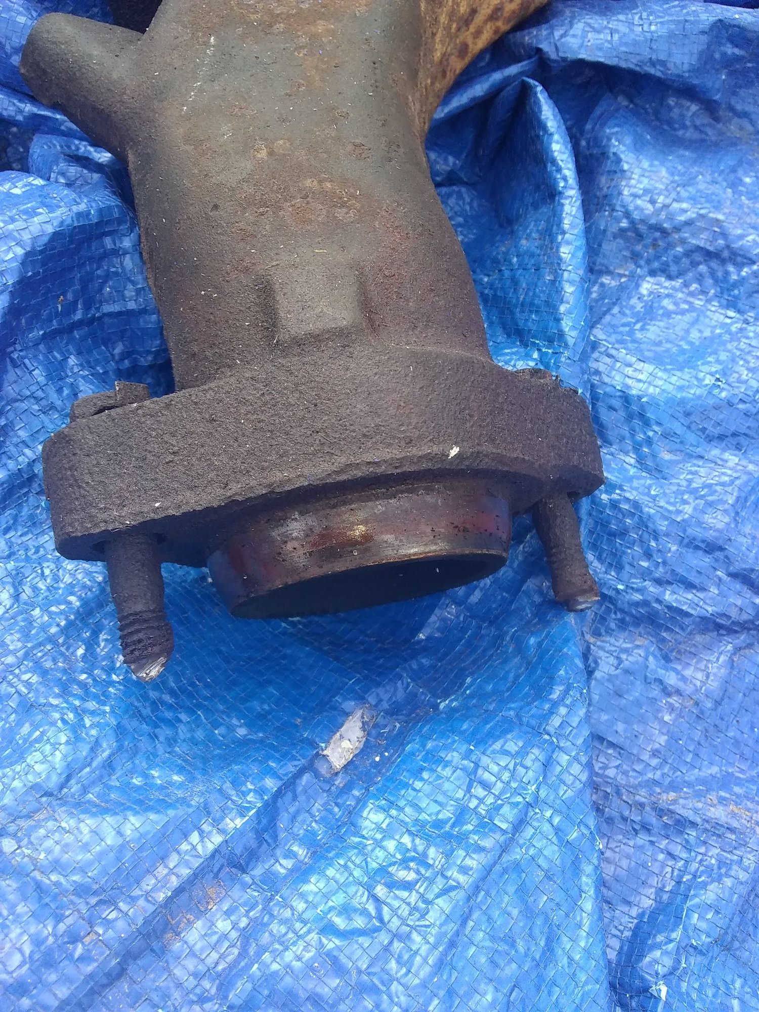

Just cut the bolts and use new ones.

Cut it with what? I have a sawzall but it's a pretty tight fit in there...
I also have a Dremel tool with the stones...

How would I cut the exhaust bolts at a pick n pull? My tools are electric.

#6 pushrod or connecting rod? If it's the pushrod it will just pull out either with the head out if you just pull it. Cut it with anything you can get in there for the bolts. The Magnums are single cam as they only have one cam gear (can't remember if you did a timing chain as you would have seen only one gear dual overhead cams have two usually one on each head). Also they technically aren't overhead cams, our can runs tight down the center of the motor.

I'll see if I can squeeze the sawzall in there, otherwise I'll try to grind it with the Dremel.

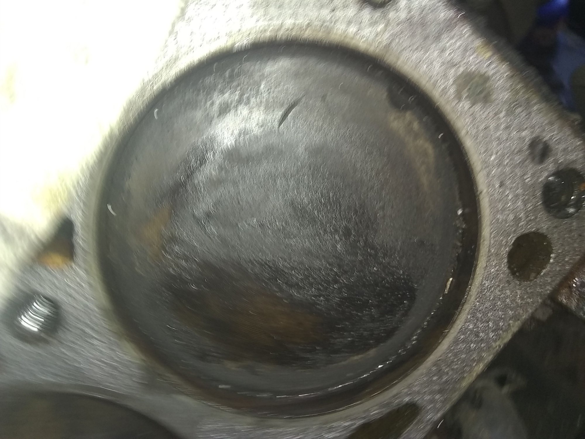

Sorry it took so long. Had trouble with those exhaust to pipe bolts. Bought some cutting wheels for my little Dremel. Sawzall didn't work too well.

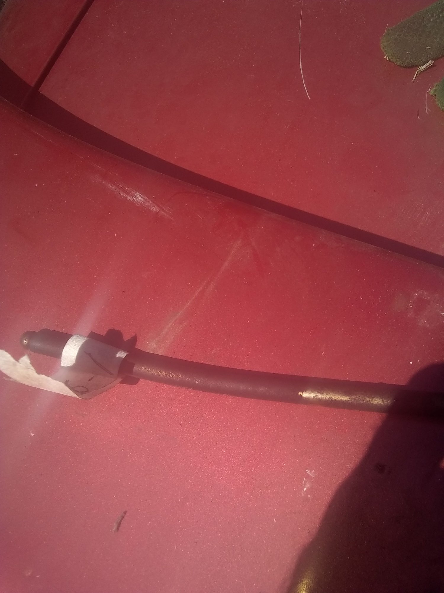

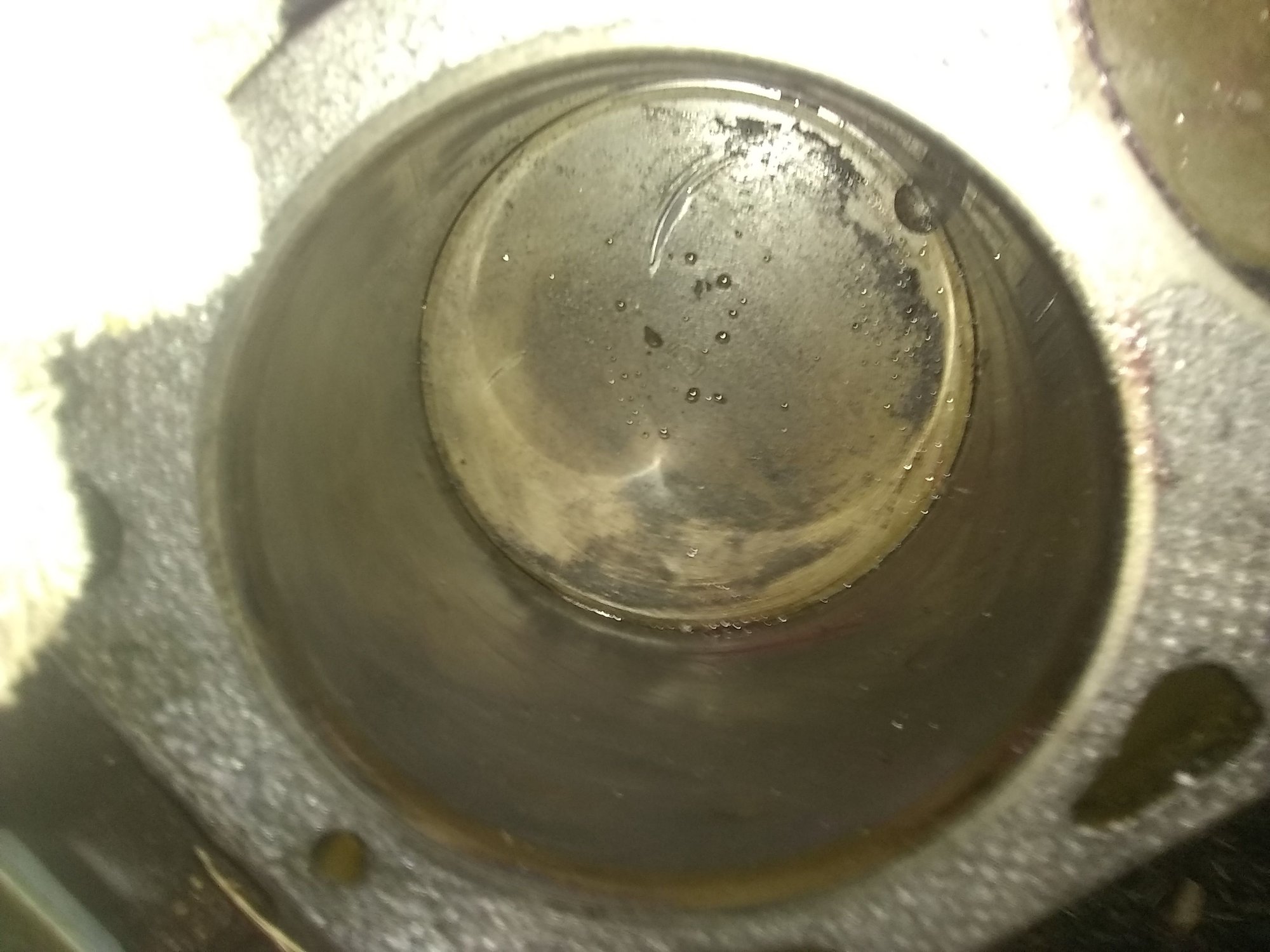

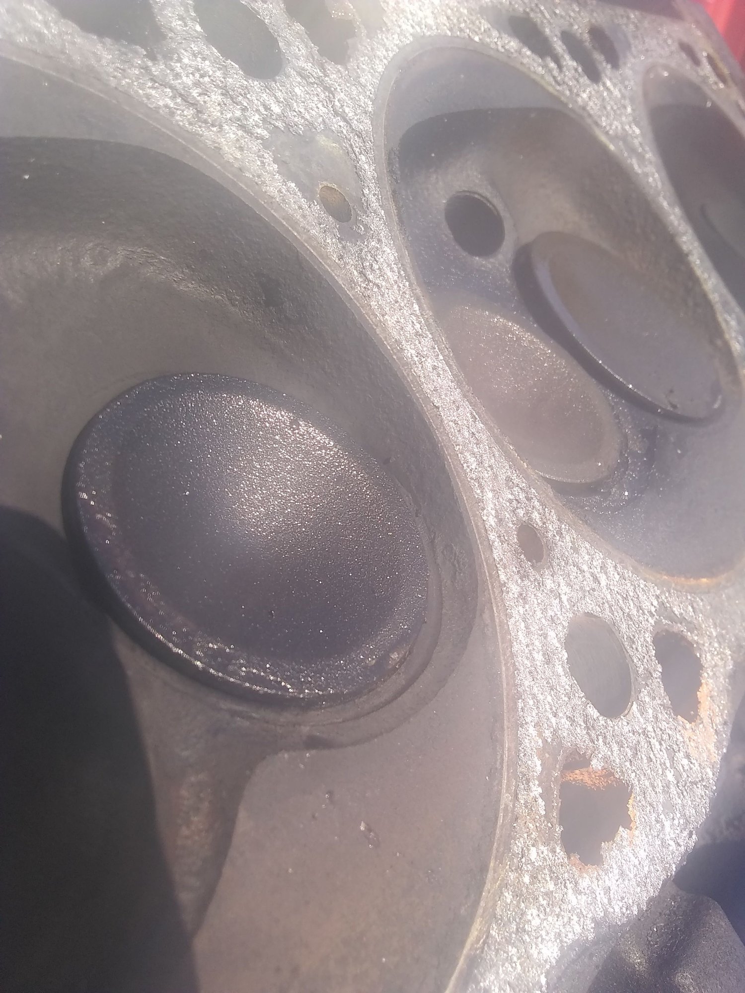

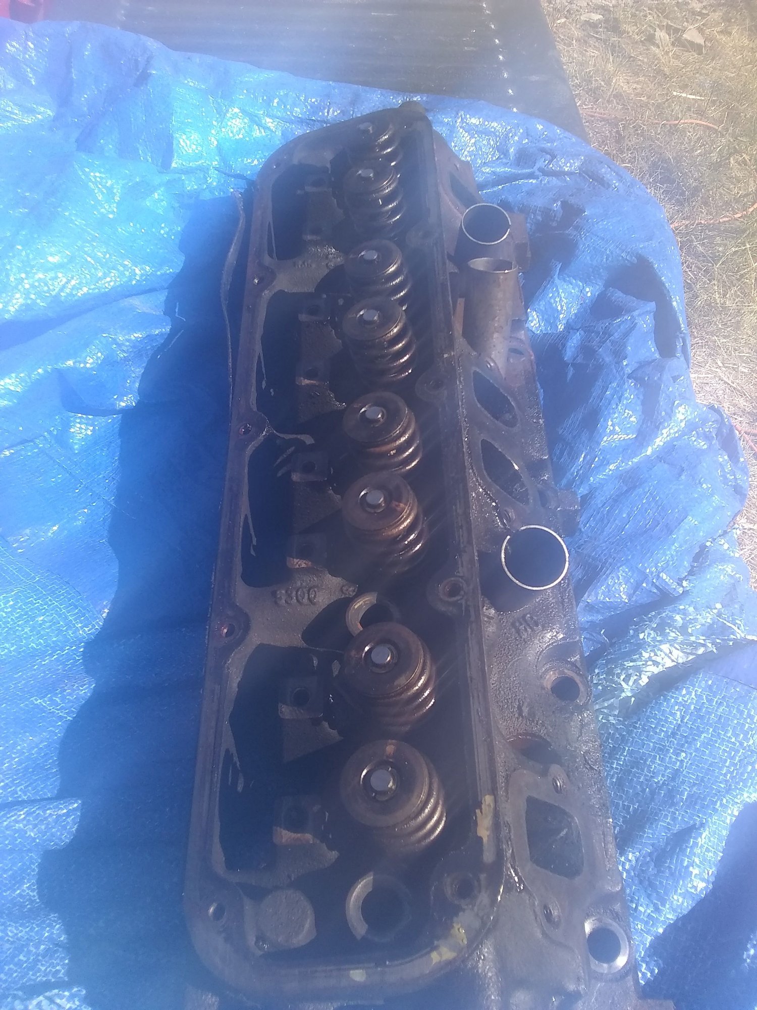

Found one bent rod, and 3 valves on cylinders 4, 6, and 8 that caused no compression. Only got the passenger side head off so far. The was fluid in the cylinders but that might have been from taking off the head. I did drain the coolant and oil.
I think I will reuse the pistons and block. There was no damage to the pisPist that I could see.
Now, what caused the bent rod and valves not to close? Cam? Are the valves sticking or bent. Did the timing chain break and cause it or did the valves cause the chain to break.
I do have a valve spring compressor so I'll need to work on getting the valves out and disconnecting the other exhaust pipe and removing the other head.
I think I would like to just replace all 16 valves and put the heads back on... And clean everything up.
What all do I need to change along with the valves? Guides? Seals? Ive kinda done it before but also changed a couple lifters ona cavalier and didn't know I was supposed to change ALL the lifters at the same time.
I'd like to hone the cylinders, put new valves in, and clean the heads up along with a new gasket set.
Can I get some suggestions and guidance please?

If the timing chain broke while the engine was running, the cam would stop turning, leaving a selection of valves hanging open, which the pistons then hit. You can see the divots from the valves in the tops of the pistons....... Those scars will cause trouble if you leave the pistons in there. The sharp edges will promote hot spots, which will cause pre-ignition (spark knock) which can destroy your engine. Time for a full rebuild, or replacement.

Well 8 pistons and 8 rings then? Stock size? I didn't do a very thorough inspection but I didn't really see any damage. I look along the cylinder walls and the top of the Pistons.
Shouldn't be too hard to change the Pistons? Take off the oil pan and switch them? Do I have to remove the block?
