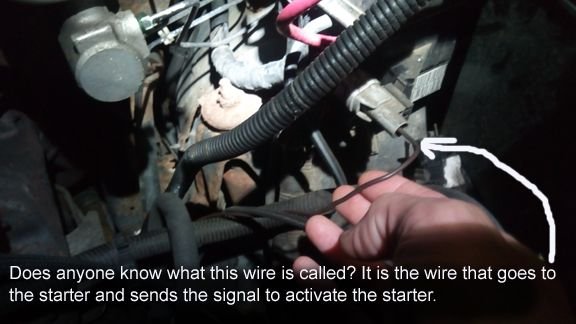

Sorry for the delay in responding. I didn't get home until late Monday night and these past two days have been very busy. I picked up a battery cable to run from just the battery to the fuse box, but I have not yet installed it. I also asked at Oreilley's about the cable that goes from the alternator to the main wire harness, but they didn't know which wire I was talking about, and I didn't have my truck with me at the time to show them. I'll stop back in and ask about that when I either have my truck or pictures of that wire. I also asked them about the small wire that goes from the connection near the fuse box to the starter, as I wanted to replace it, but they couldn't figure out what that wire was either. I have attached a picture of it. Does anyone know what the name of that wire would be?

Wire to the starter is just a wire, and the parts store won't be able to get you anything specific. If you want to replace it, just get some wire that is slightly larger, and cut/splice it in.
