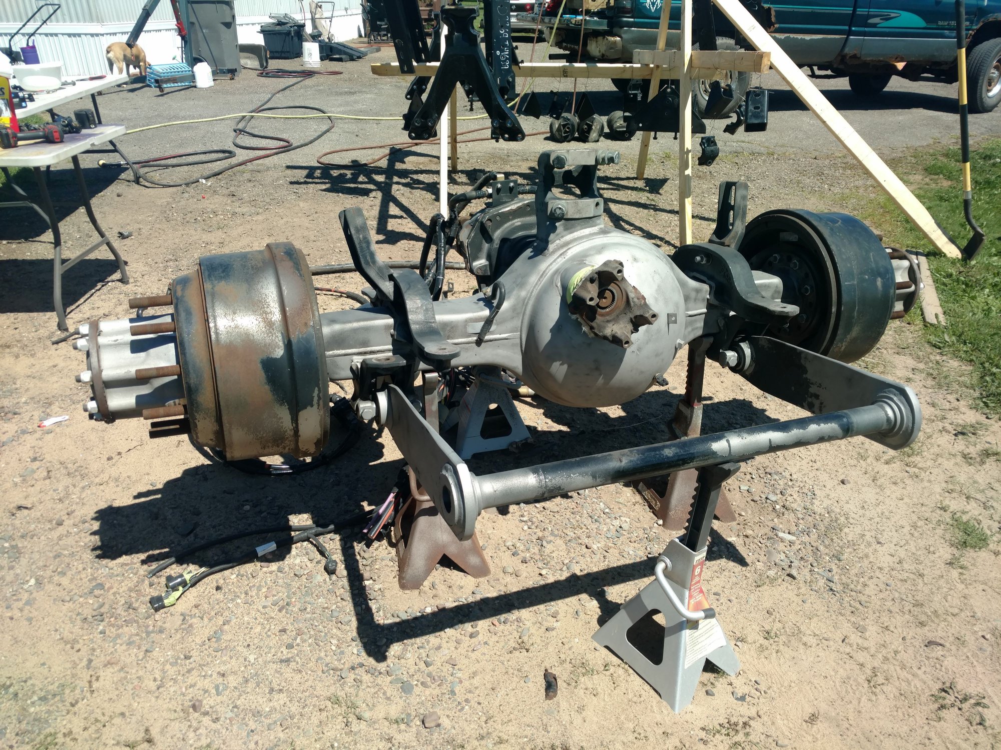

I sand blasted the axle housings. I didn't have a way to move them after blasting, so they got sprayed right there. It was a Sandy mess. Your axles won't weigh 1500# though.
These parts were cleaned and then scuffed with 3M scotch Brite pads. I should have built 2 stands. The parts were to close to each other to get around them with the spray gun.
3M Accuspray. I used the 1.8 mm tip to spray KBS Rust Seal. It can be sprayed over scuffed or blasted surfaces. There's another product to use first if you can't remove all the rust.

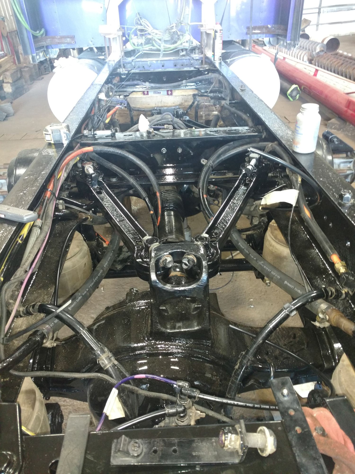

The frame was water blasted. It's quick and keeps the metal cool so it won't warp sheet metal.
We used small rollers to put 2 coats of KBS on the frame
KBS is very tough. You can see a ton of parts got dragged over the frame to be installed. No scratches or chips. We tried to be careful, but some of the parts were quite heavy.
I'm going to try it with out a top coat. It will fade in direct sun. If it fades they have a special primer that adheres to cured Rust Seal. Then I'll paint it purple to match the truck.
