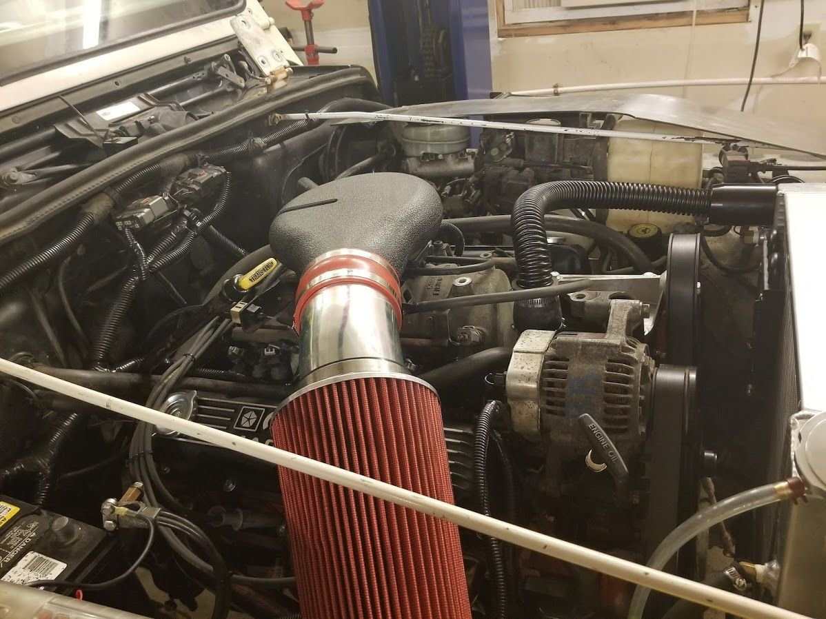

Hey all, incoming wall of text.
I feel like I've been reading DodgeForum threads in my sleep for the last few months trying to figure out a nagging low power problem on a 5.9 Magnum that I swapped into a Jeep TJ.
Where to begin... well, I swapped the drivetrain from a '99 Ram 1500 into my '99 Jeep Wrangler over the winter. It's running well, sounds good, idles smooth, shifts through all the gears, etc, but it just doesn't have the power I feel like it should. It's on 35" tires with 4.88 gears, and literally won't spin the tires in dirt. Drops out of overdrive on any minor hill on the highway. I have a '97 Grand Cherokee with a 5.2 that will blow the doors off it, with stock 3.73 gears on 31's. It seems to be missing power at all RPM ranges, not just low end or high end, so I feel like I'm looking for a systemic problem. It SOUNDS fine when accelerating hard. No pinging or missing or stumbling, it just doesn't GO like it should. Like I'm dragging a trailer around.
Starting at the beginning:
The donor truck had about 200k on it, ran okay but the trans was slipping and had burnt fluid in it. I yanked the drivetrain, stripped the motor to see if if needed a rebuild, and found crosshatching still on the cylinders, so I went with a re-ring kit. Cleaned all the carbon off the pistons and ran a ball hone through the cylinders, changed out main and rod bearings and put her back together. Cam bearings were smoked so I changed those too. Heads were cracked of course, and I replaced them with THESE HEADS. Put the engine back together with the stock cam, new timing set, new lifters, original pushrods and rockers. The engine got a new oil pump, new distributor, new cam, new coil, new crank, water temp, oil pressure, O2, and MAP sensors as well as plugs and wires, etc. I did not change the IAT, TPS, or IAC. I put THESE BLOCKHUGGER HEADERS on to fit my application so the engine would fit in the Jeep's engine compartment.
I rebuilt the 46RE trans, replaced both bands and all clutch packs (frictions and steels) and installed a TransGo shift kit. It got hot on me after a long trip down the highway about a month ago, hot enough to go into limp mode, so I changed out the fluid and filter and added an auxiliary cooler and a temp gauge. So far so good. There was a little more metal than I was expecting in the trans after 500 miles, but I didn't change the torque converter (idiot) when I did the rebuild so I'm guessing it was leftover crap from the old fluid, because there were no signs of excessive wear in the trans when I pulled the pan and valve body and looked over the clutch packs and bands again. Shifts fine, has all 4 gears plus TCC lockup working properly.
I built the wiring harness myself using the factory service manuals for both vehicles, obviously using the PCM from the '99 Dodge. The evap system is hooked up and working properly. There are no check engine lights. Since they are both Chrysler products with a CCD bus, the Jeep gauges work correctly and show all the same values that I read on a scan tool. The custom exhaust that I had made includes a catalytic converter and both O2 sensors installed. I performed the distributor fuel injector sync with a scan tool since I had changed the distributor.
As I said, it's in a Jeep TJ Wrangler on 35" tires with 4.88:1 gears. The same ratio I was running with the 4.0 inline 6 that I removed. It feels normal when cruising around town off-idle, but when you get hard on the throttle, there just isn't much there. If anything, it has the same or a little less power than the 200,000 mile 4.0 liter with a manual trans that I pulled out of it. It cannot climb a moderate hill on the interstate without dropping into 3rd gear, and with 4.88s it's turning about 2300 rpm at 70, so it should have plenty of torque to stay in O/D. The vehicle is a street legal 4-wheeling/rock crawling rig, and there have been a few instances where I've been pushed up against a rock in 4-low and floored the accelerator and it just sits there and bogs, where I was expecting wheelspin. The only "real" symptom I can come up with is that, under hard throttle applications, I get a very slight sulfurous / catalytic converter smell, but I put a backpressure gauge in the front O2 sensor bung and there is 0psi of backpressure, so the brand new cat is not plugged, even though that seems to match some of the symptoms.
I feel like the cooling system pressurizes a little more quickly than expected when the engine is started, but there are no bubbles and no signs (smell) of combustion products or oil in the cooling system, or coolant in the oil to indicate a head gasket or water jacket problem. It does jump to 20psi within a few minutes of the engine idling. Even if this was an issue, I wouldn't expect it to cause this significant of a power loss. This motor is meant to drag around a 8000 lbs one-ton truck, it should RIP in a little Wrangler.

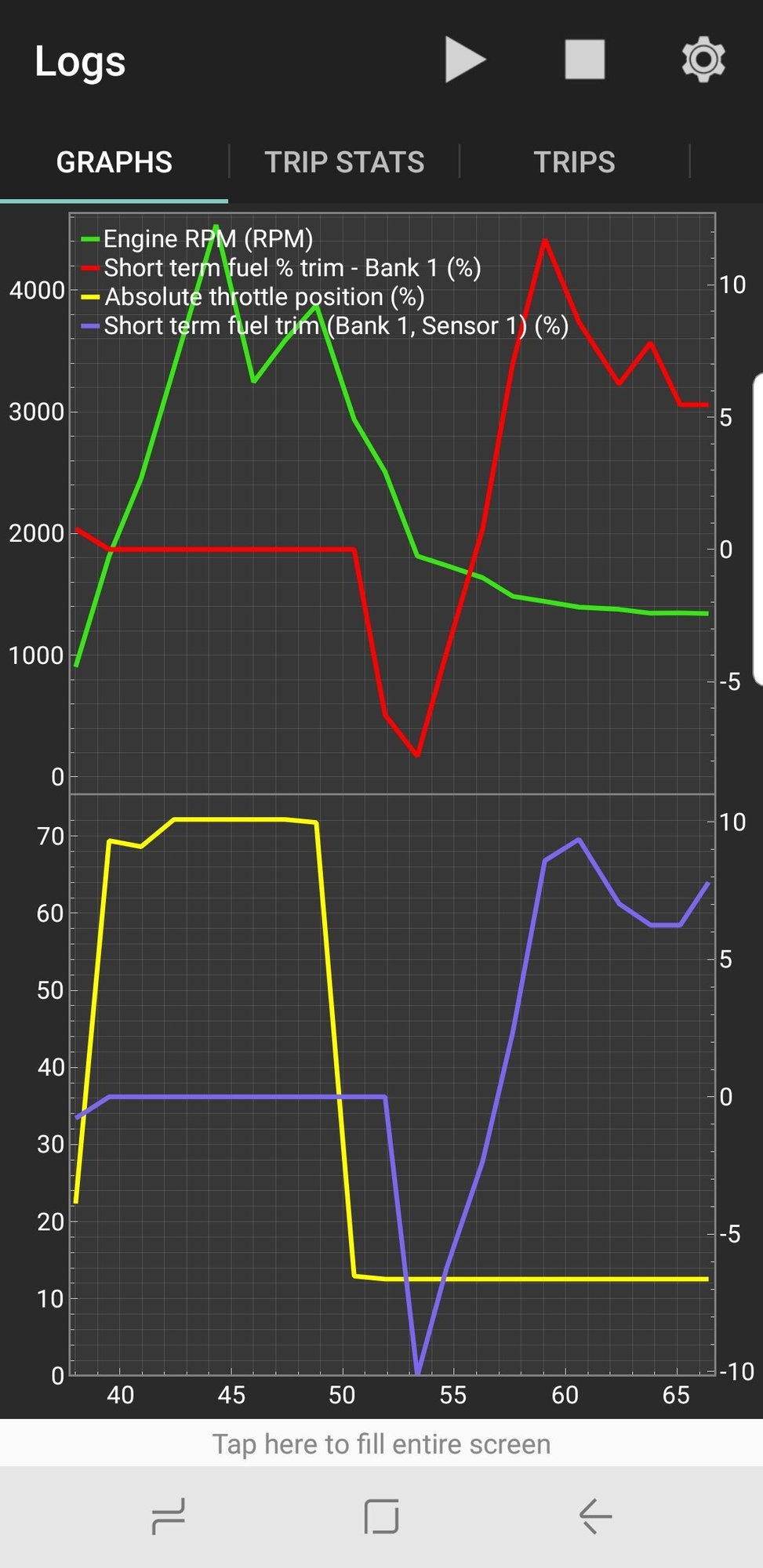

I had time to log a couple full-throttle takeoffs on my coffee break using the obd software on my phone. It will only let me log 4 data streams at once, so the graphs are slightly different. Looks like fuel trims level off during heavy loading, expected because the PCM runs off tables at full throttle, correct?
Only thing that jumps out at me is timing. Seems to be retarded pretty significantly from what I expected. I assume this is for knock prevention? Is this the death flash I've seen so much about?
To be honest, it actually felt sort of okay other than the first 50 feet or so. These were basically 0-60 full throttle.

Got a couple more graphs on my lunch break.
Getting on the highway and up to 65:
and 35-45 mph cruising on side road. You can see a little spike in throttle position when I hit a little hill, and resulting drop in timing advance. Normal?
