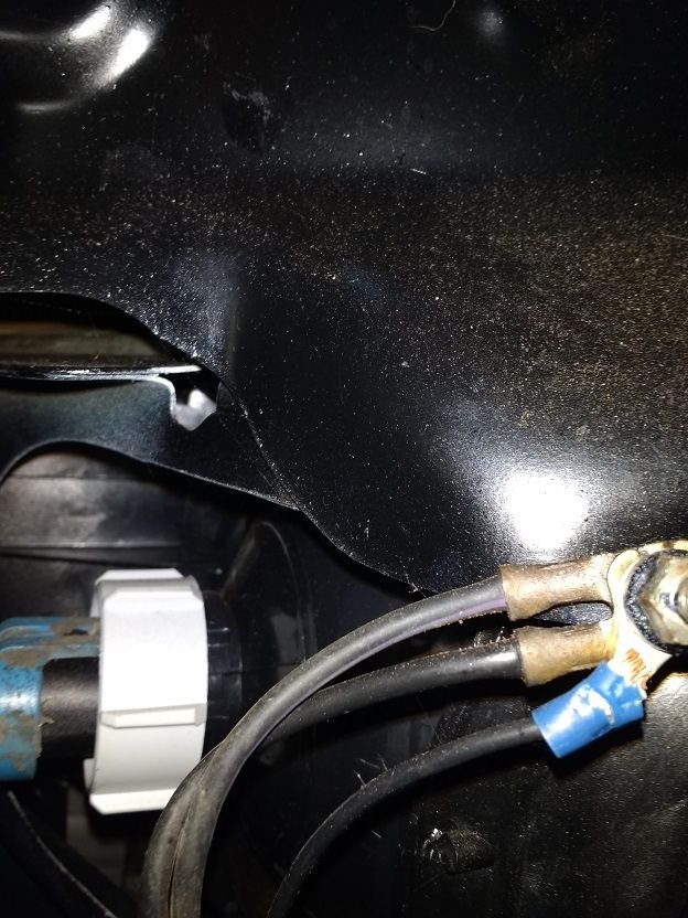

Can't really see much of the hack, I just attached a wire to the ground and bolted it down to the fender. What was strange, I had to do both of those. Just a couple weeks ago the wipers stopped working, and I did a similar hack to make the wipers work again too.

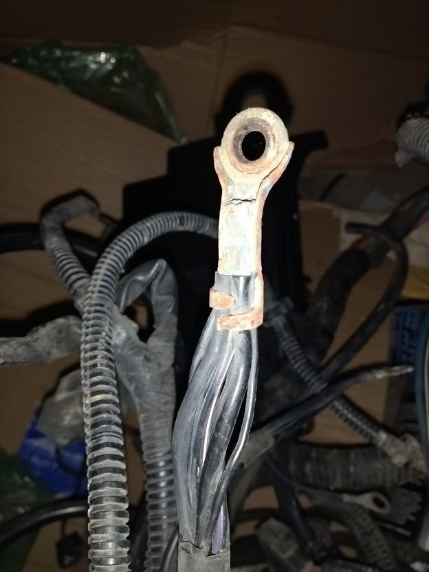

I added a picture of my spare harness, and that thing is green with corrosion, harder to see - pic is overexposed....

Interesting as I don't have they ground cluster under the battery mine (01 2500) go to a ground block beside the battery. I'm going to cut off the left turn signal socket and see if it changes
