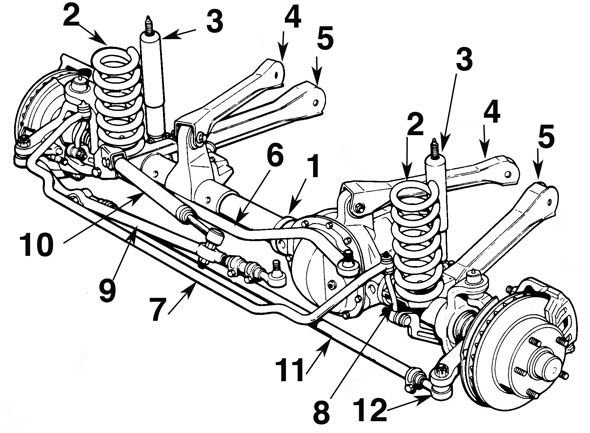

there is a good inch of play in the steering bar thing, up and down,
You may want to give the "thing" a name. If you have that much movement it will cause the wobble. I think you are talking about the pitman arm rod end. It's not named here but it's right in front of the diff cover at the end of the drag link. This is not exact to our trucks but it gives you the names.

From this I'd say my Drag Link and Tie Rods are all busted, a good inch of play is in the Drag Link.
I'm sure the track bar could be replaced as well, thank you for this diagram!

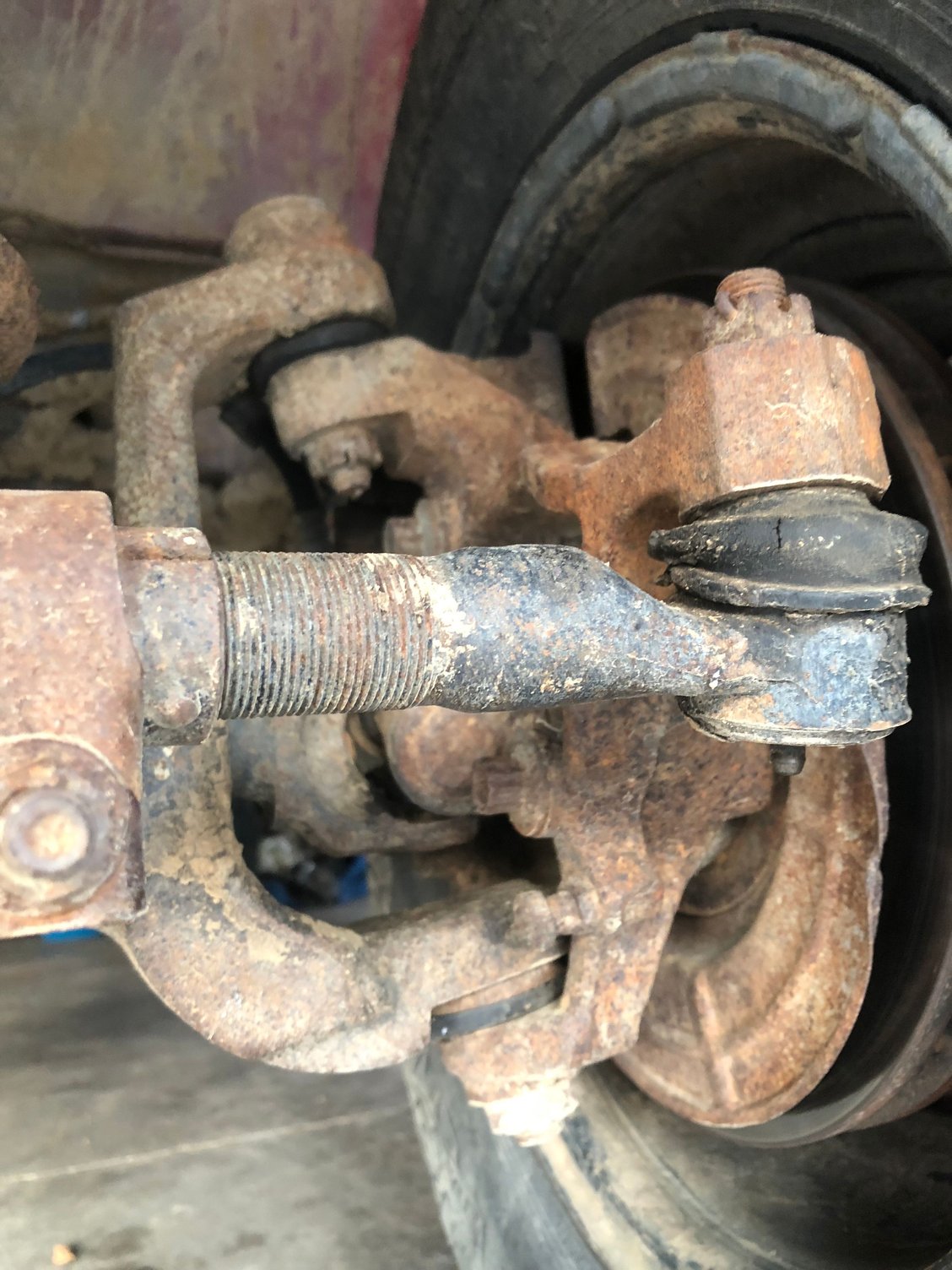

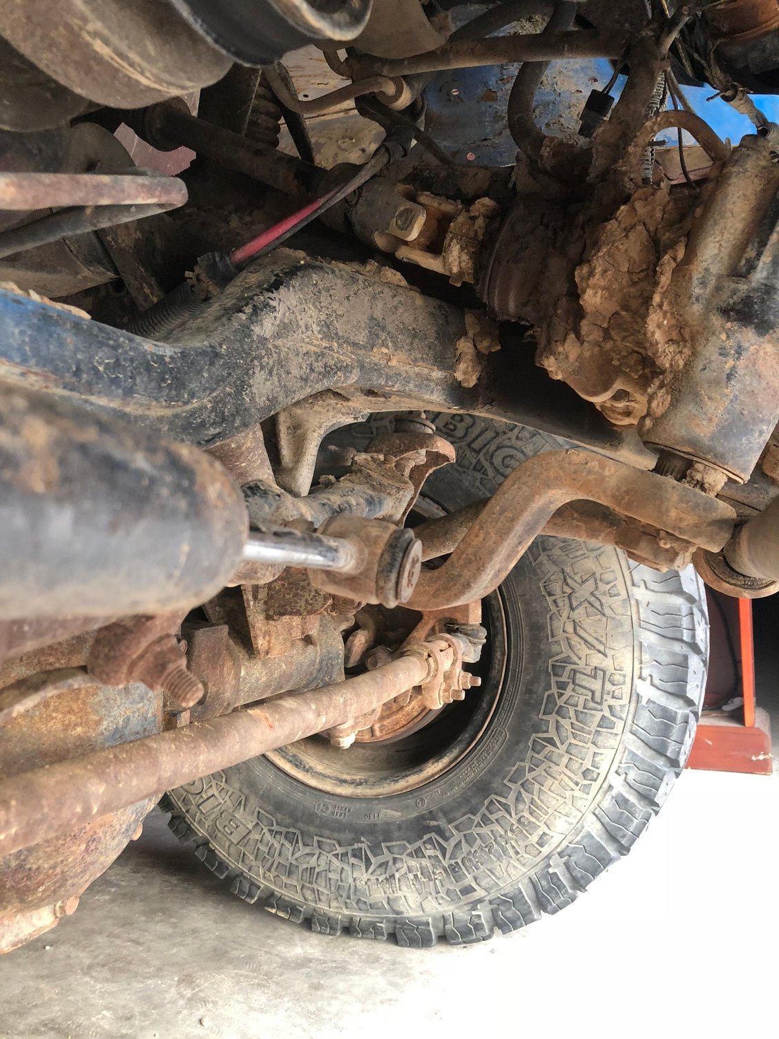

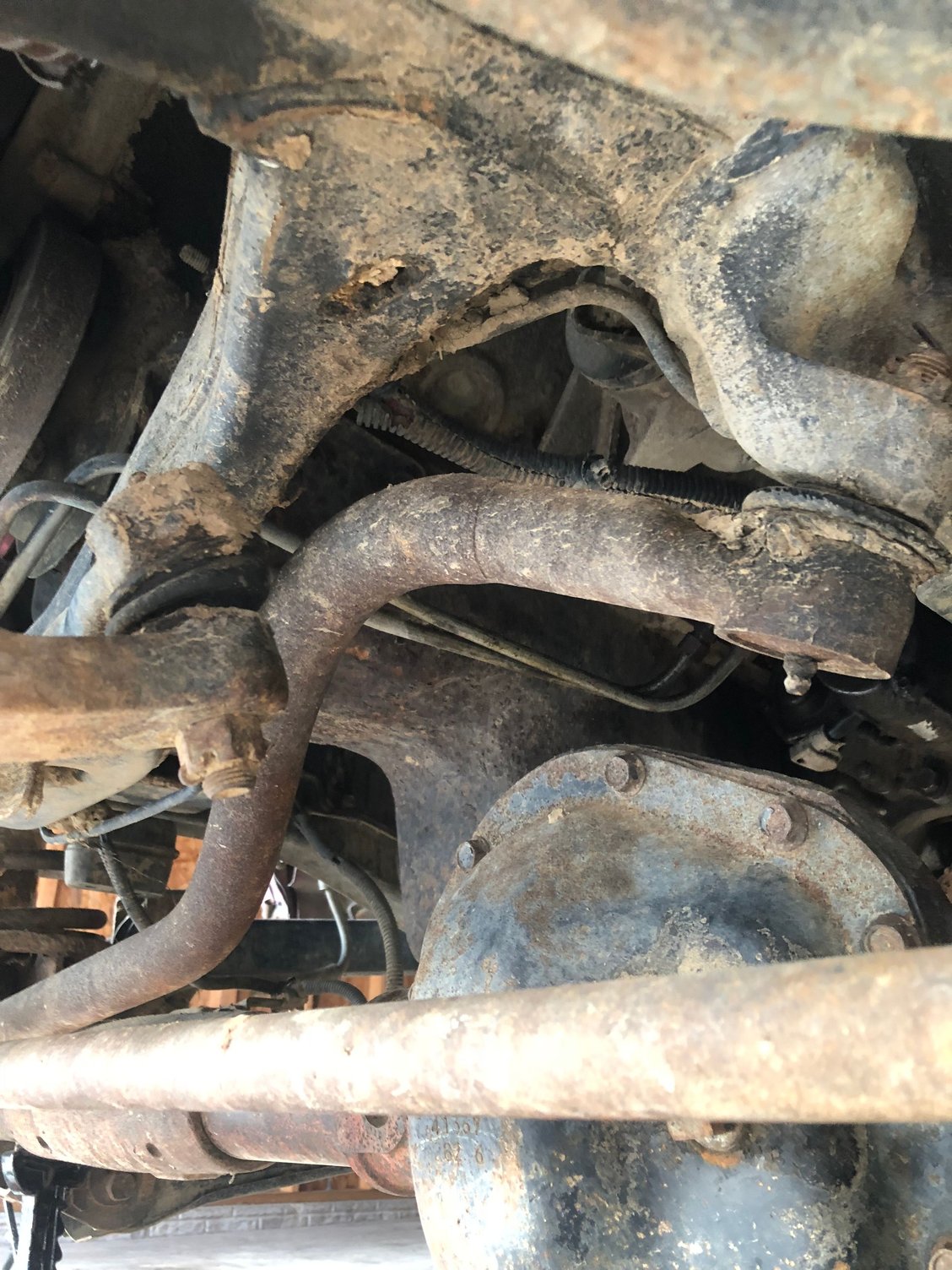

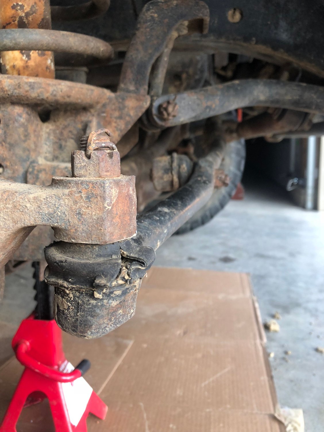

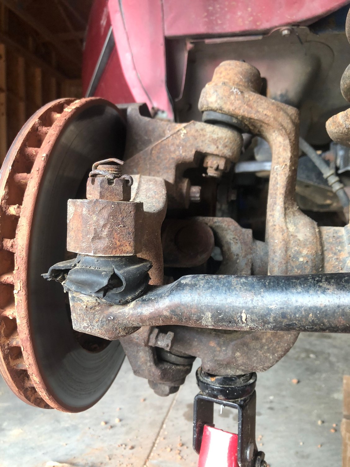

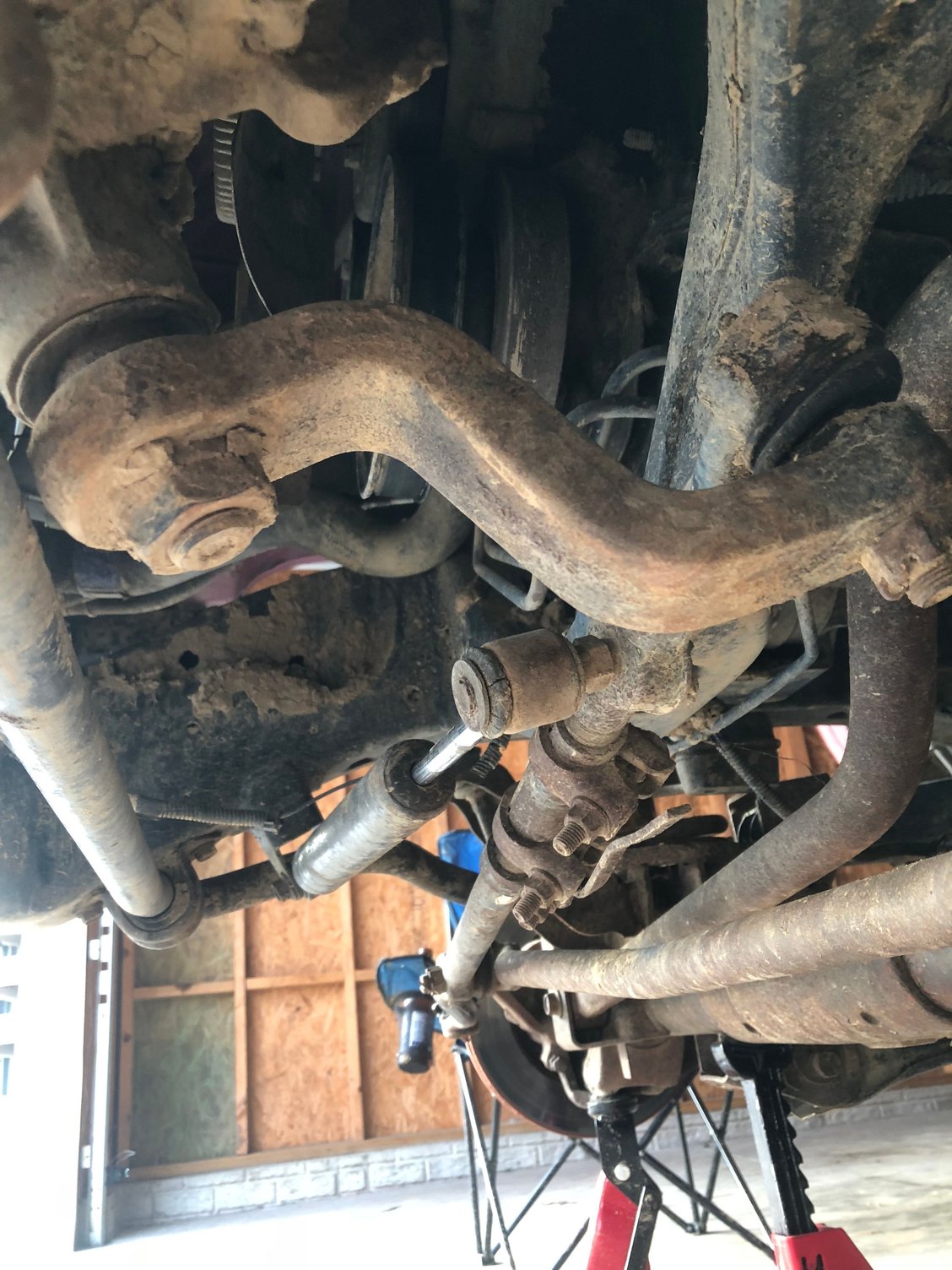

Old Aug 4, 2018 | 10:17 AM
Jaw91097's Avatar
Jaw91097
Joined: Mar 2018
Posts: 278
From: Peoria, IL
Old Aug 4, 2018 | 10:56 AM
racefan41's Avatar
racefan41
Joined: Jan 2016
Posts: 593
Likes: 8
From: Shawnee, KS
I don't know much about oversized tires, but is that a lot of wheel weights all in a row?
