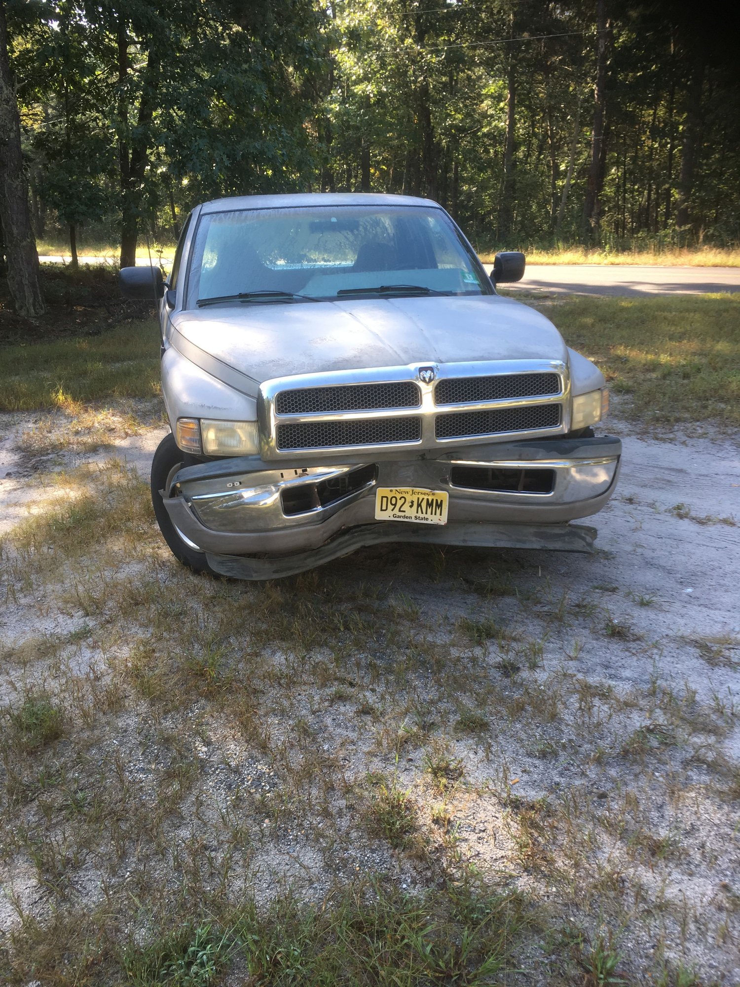

Seriously bummed but I'll find something a little more custom for a bumper
Old Sep 19, 2018 | 10:59 AM
Posts: 87,482
Got pics of the other guy? Bet he didn't drive away......
