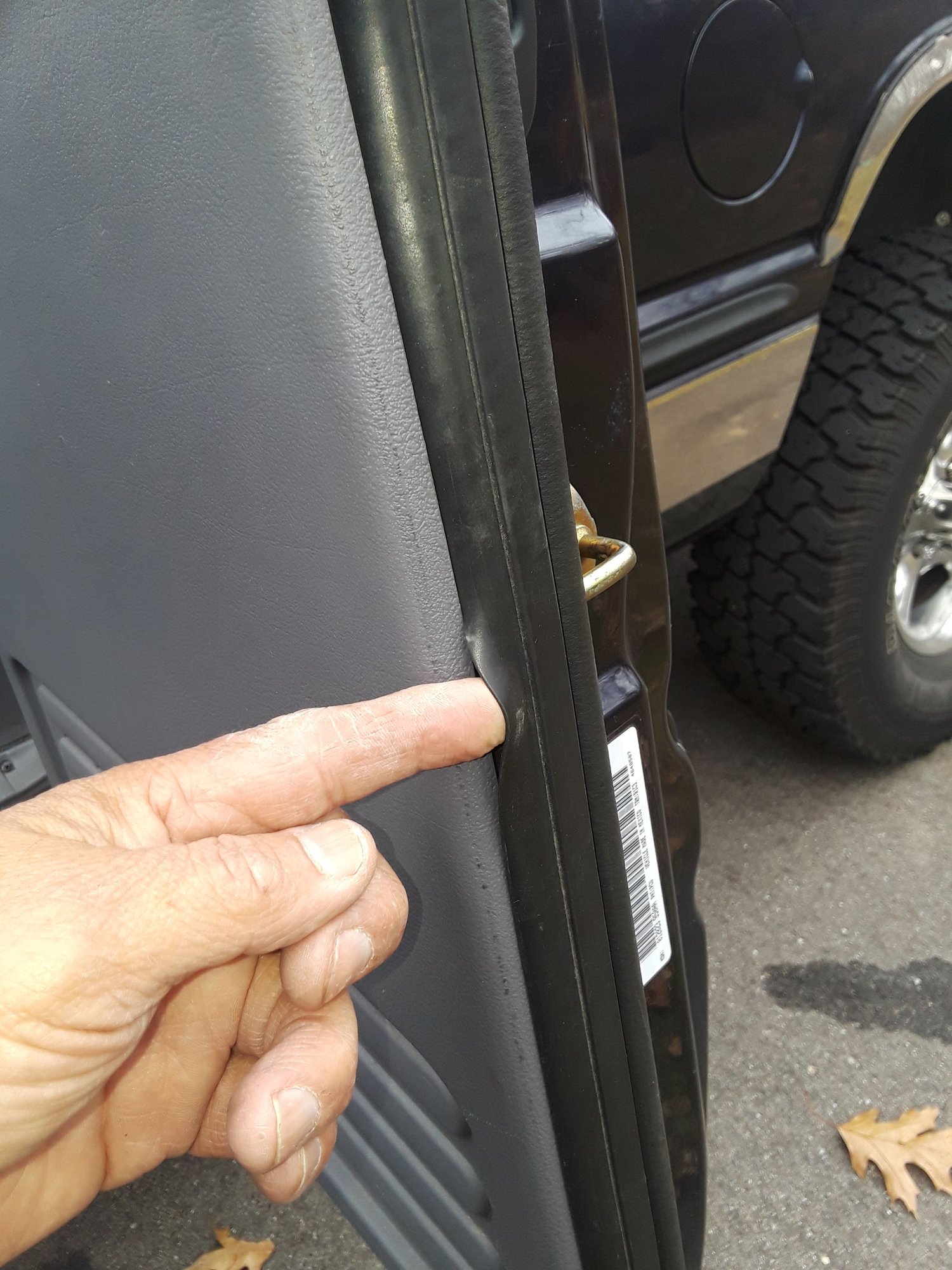

While putting in new rear door speakers, the plastic retainer
ends of the door latch cable broke. The truck is a 1999...they were old and brittle.... I imagine a lot of plastic is that way on this truck.. This is how I replaced them if anyone is interested. Thanks for looking. The pics are not in order. I found the cables made by Dorman on Amazon for $21 each.. other places wanted from $34 to $44 each. I also re-used the yellow retainer clips... a little beat up, but still worked just fine... just had to line them up carefully and make sure they actually went into the hole. This was the hardest part of the whole job.
did not have to remove weatherstrip, just slipped my finger behind it and slid it up to re-seal it.

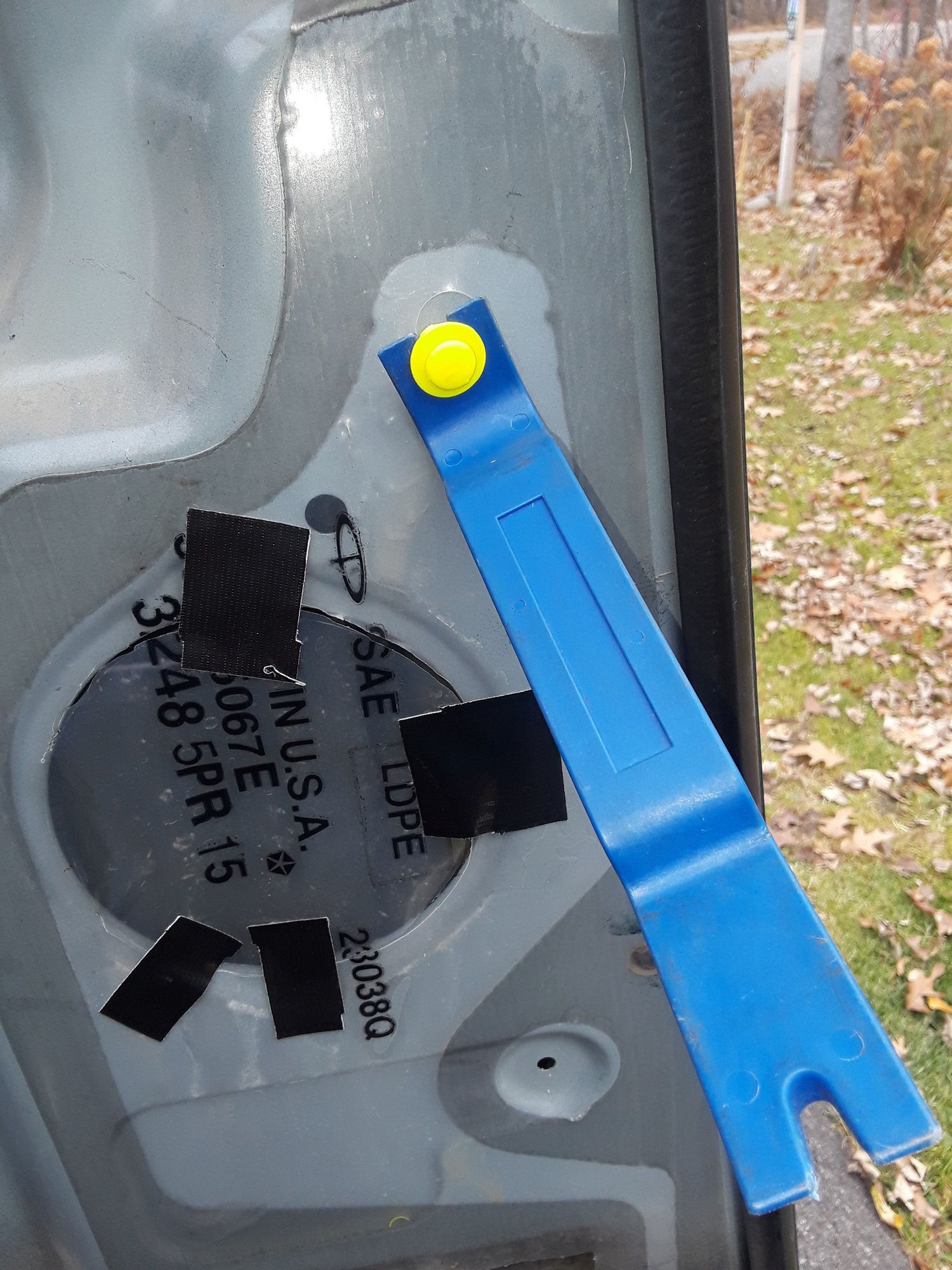

used this plastic tool to remove door panel and clips... screwdrivers and pliers gouge paint and dent metal... matters to me alright???!!!
this is behind the door panel handle... I sprayed some silicone on it to help the retainer snap in and to lube the mechanism.
I sliced the plastic around this access hole and folded it into the door cavity and taped it up when done.
