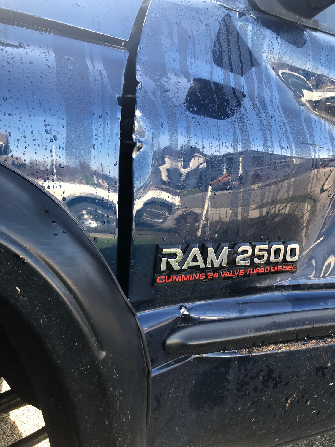

okay, my door was damaged when my e brake cable broke as I was getting out of the truck. I had my PR Cruiser in the driveway next to the truck so when the truck rolled backwards about 5-10 feet, the cruiser caught my door and bent it backwards. I was able to force it to close so I could drive it, but now it won’t open more than 8 inches, which isn’t enough room to access the hinges to get the bolts out.
I have factory black plastic flares on the fenders so I can’t see if there is damage to the fender or not. I thought that the fender was only the outer skin, but found out the fender well is spot welded to the fender. I’m afraid to force the door open enough to access the hinge bolts since the damaged door contacts the fender above the logo on the door. Should I force it open or do I have to go through with removing everything attached to the fender well and then remove the fender to get the door off? Since I have a diesel, it *looks* like it would be a pain to remove all of the stuff that’s attached to the fender well. Any ideas?

If you're not planning on salvaging that door then you might be able to bend back that front part of the door where the hinges are and see if you can get some tools in there. You can see the top hinge through the gap in the first picture. There are 2 bolts holding the hinge to the door itself. They are threaded in facing the rear of the truck so you might be able to get a socket in there to unbolt them that way.

I took your advice and was able to remove the door and lower hinge and the two outer bolts from the top hinge but cannot get the bolt for the top hinge from the inside of the cab. I have two bolts out that hold the ebrake assembly on, but can’t access either the hinge bolt or whatever 3rd bolt holds the ebrake in place. I removed the door and hinges from the donor truck yesterday from a 99 1500 truck with ease. What gives here?
