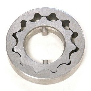

It also helps to see where the pump tangs are so you can position the converter accordingly. After that it's getting the splines to line up.
