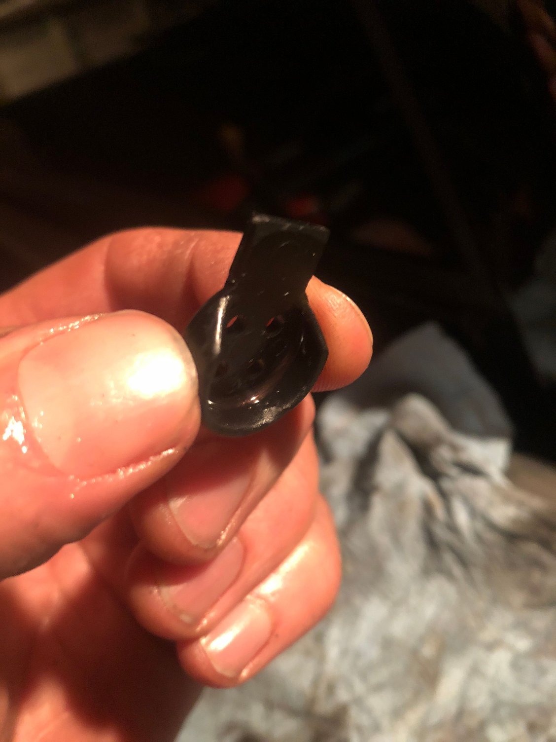

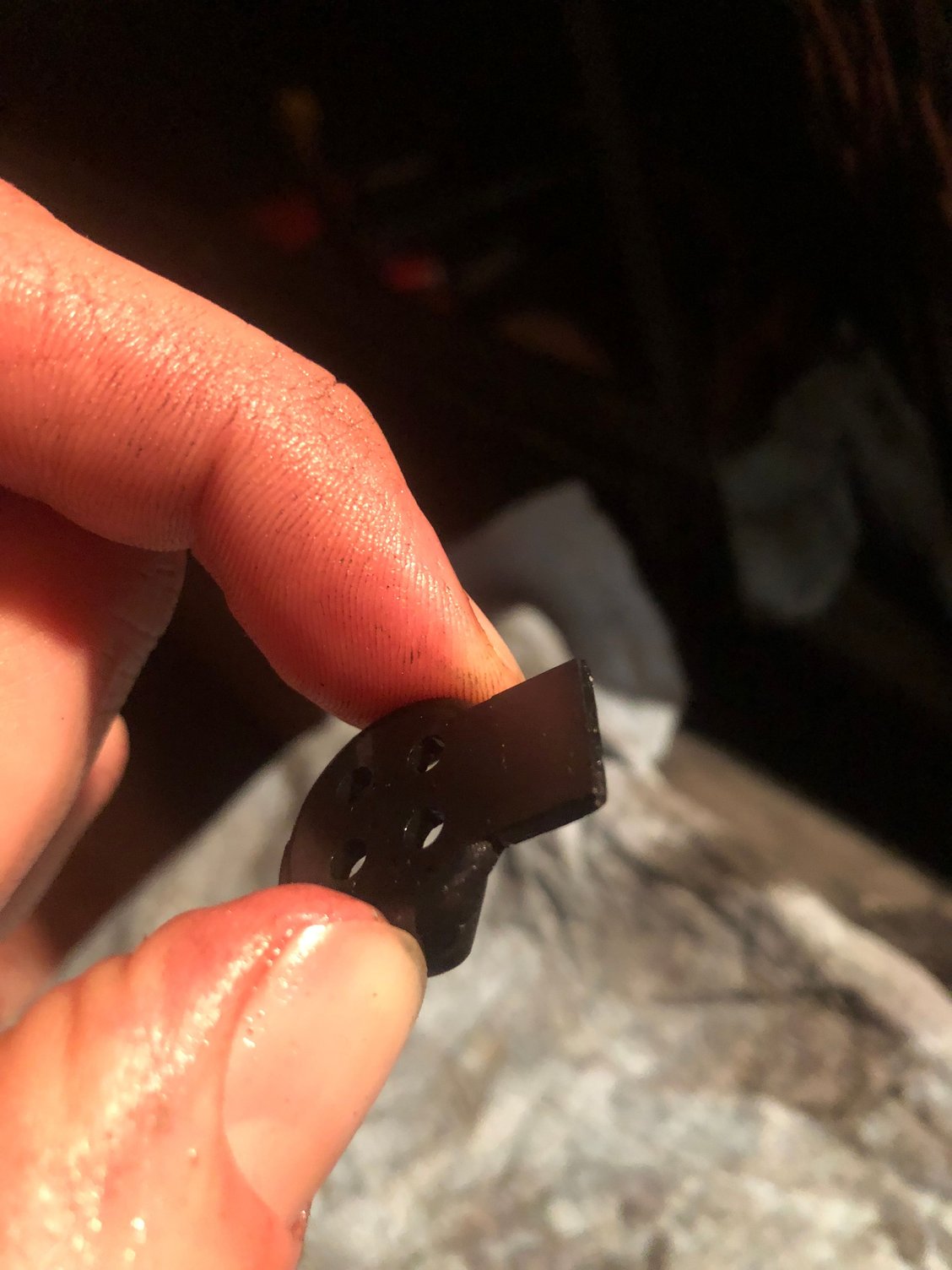

Getting a P1763 code so I dropped the pan and saw this in there, can anyone tell me where it came from?

Part of one of the sensors or solenoids in the trans?

I couldn’t find any similar objects in any diagrams or on any new solenoids 🤔

If it's a 96-99: Part of the connector for the governor pressure sensor. That would also explain the P1763: Governor Pressure Sensor Voltage Too High
