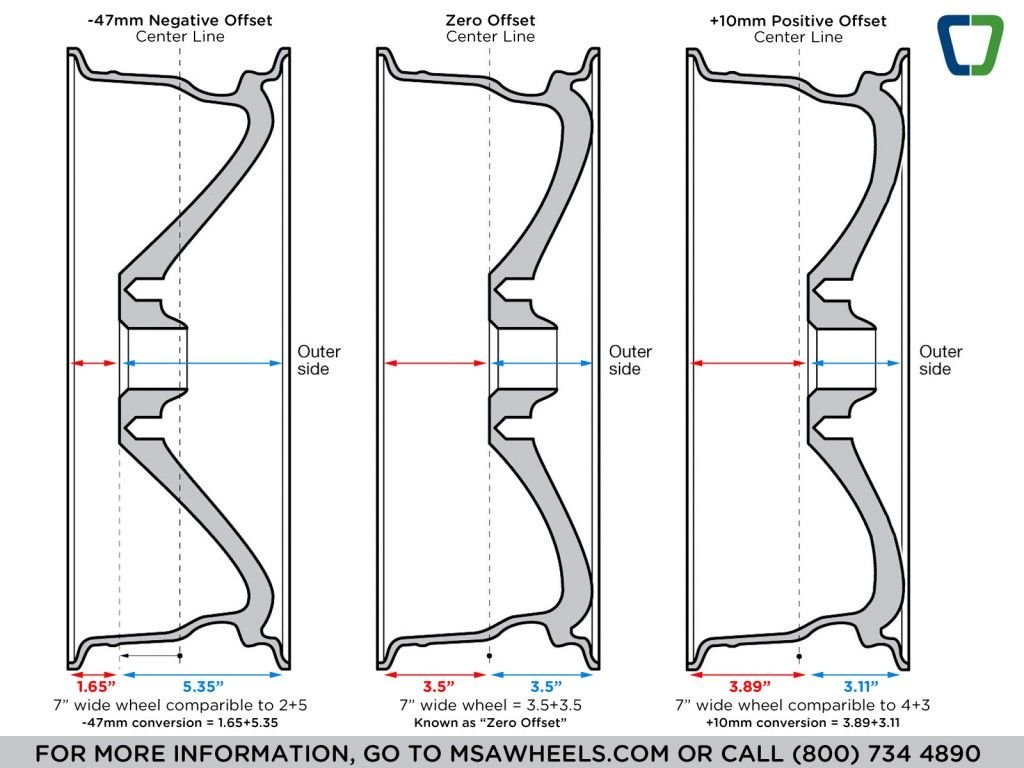

Probably means that your wheel offset is a little too much positive.
https://www.wheelpros.com/page/offset-explained/9

Yeah, but the tires are only .4 inches different in diameter. Measure the distance between the rim where it contacts the hub, and the rear of the rim. For both the 16s that didn't rub, and the new 18s. I think you will find the 18s are positioning the tire deeper into the truck.

Measure that backspace yet? I wouldn't put one spacer on - you'd want a set of 4. I'm not a fan of spacers, but people do use them. I'd just find appropriate offset rims, or live with it - it can be driven without lock to lock turning.
