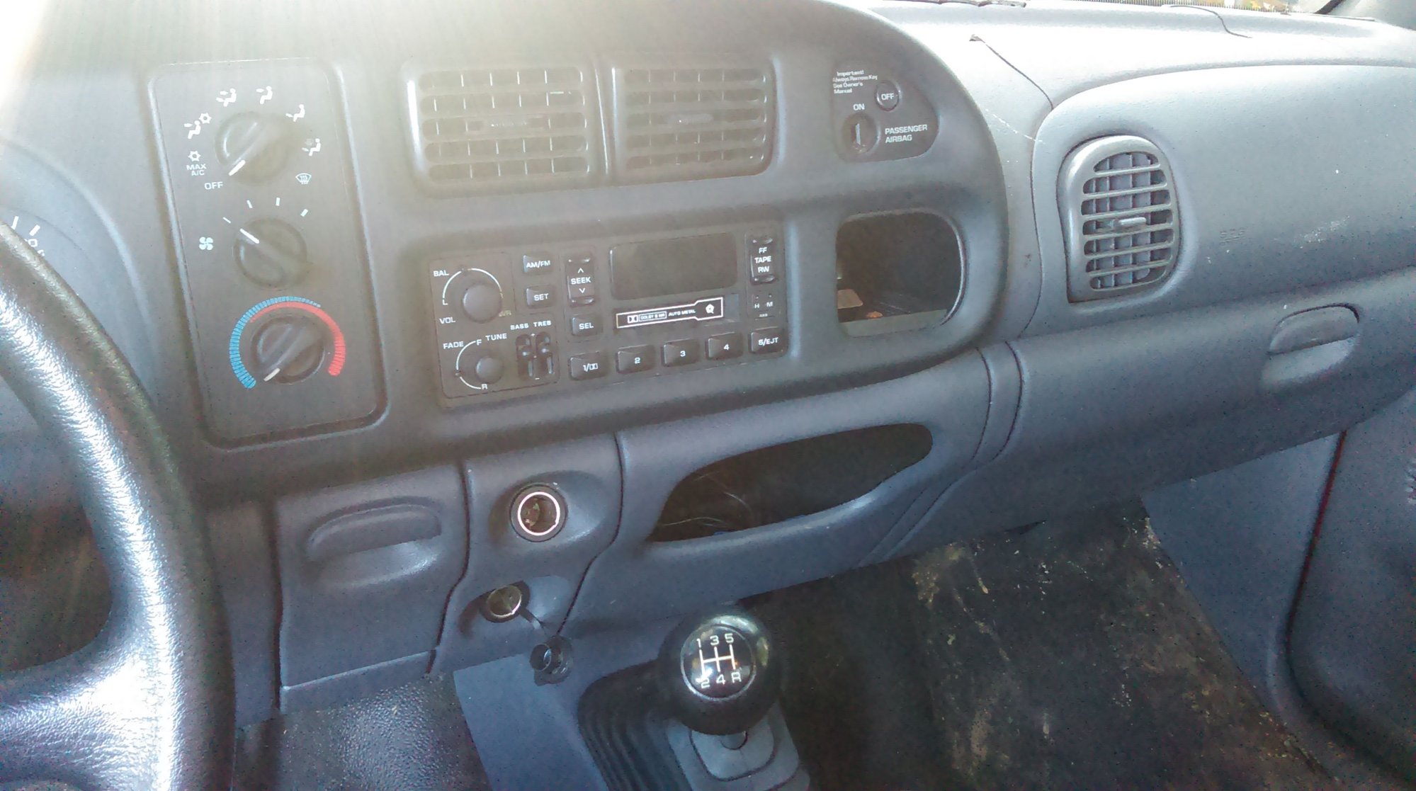

I'm a little new to this website so I'm trying to figure out everything.
I have a 2001 Dodge Ram 1500, it's a 3.9l v6 with the NV3500 5spd manual transmission pickup my grandfather gave me after he retired. Completely stock, lowest base model Ram. I've been saving up money and been wanting to do an engine swap since my v6 is showing some age (It's been running since the day she came out of the factory but I need something beefier). I originally wanted to put in a 4.7 v8 but given the costs and time, I figured it'd be easier to just go ahead and get a 318 since it's just my v6 with 2 extra cylinders and the motor mounts are the same. Question is, what are all the tools and things I need to get/do in order to get a 318 to work in my truck? I'm positive the engine's gonna work with my transmission since it's practically the same one they used in the 5 spd v8 Dakotas. I know I need the engine, and wiring harness, but what about the computer? Am I gonna need a new computer for the 318 or could I flash my v6 computer? If so, is that going to affect it's performance? As for the transmission, am I gonna need a new bellhousing? I've been told the 3.9 and 5.2 share the same bolt pattern since they're essentially near identical engines. Am I gonna need to make modifications to the transmission and clutch? What all do I need so the 5.2 works in my truck? (Pictures are from a few years ago, she's been modified slightly, tuned and cleaned since then, this is just to show what I'm working with)
