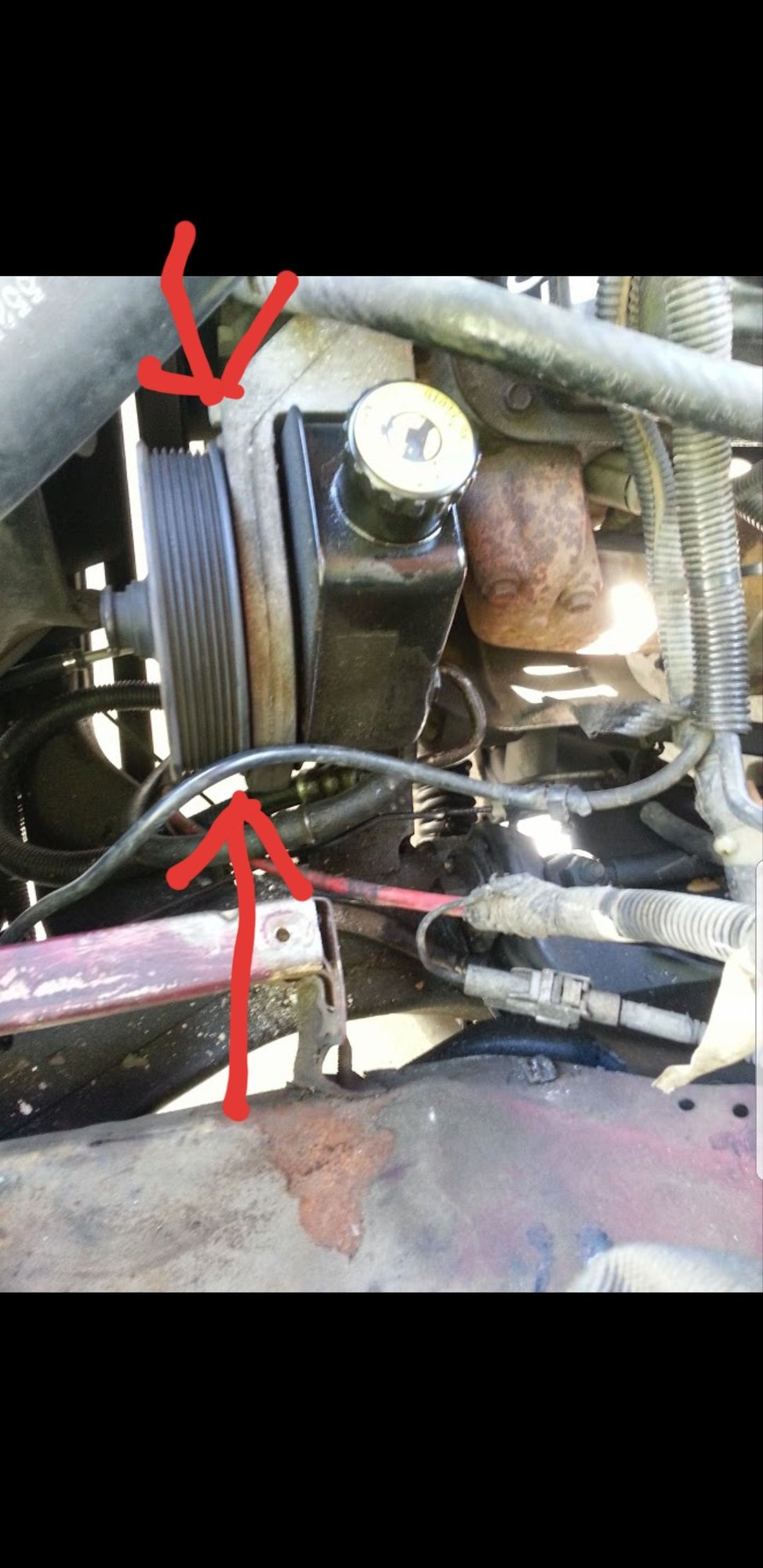

Chasing a squeaky belt and I've come to the conclusion that it's a misalignment of the power steering pump pulley.
Does anyone know or could you go measure in your truck the distance from the back of the pulley to the face of the pump?
This would give me a good starting point

You want from the back of the pulley to the bracket?

Yes that'll help

I have 1/8" from the back of the pulley to the face of the bracket on a '99 5.2l.

I have a little over 1/8 01 Ram 5.9L
