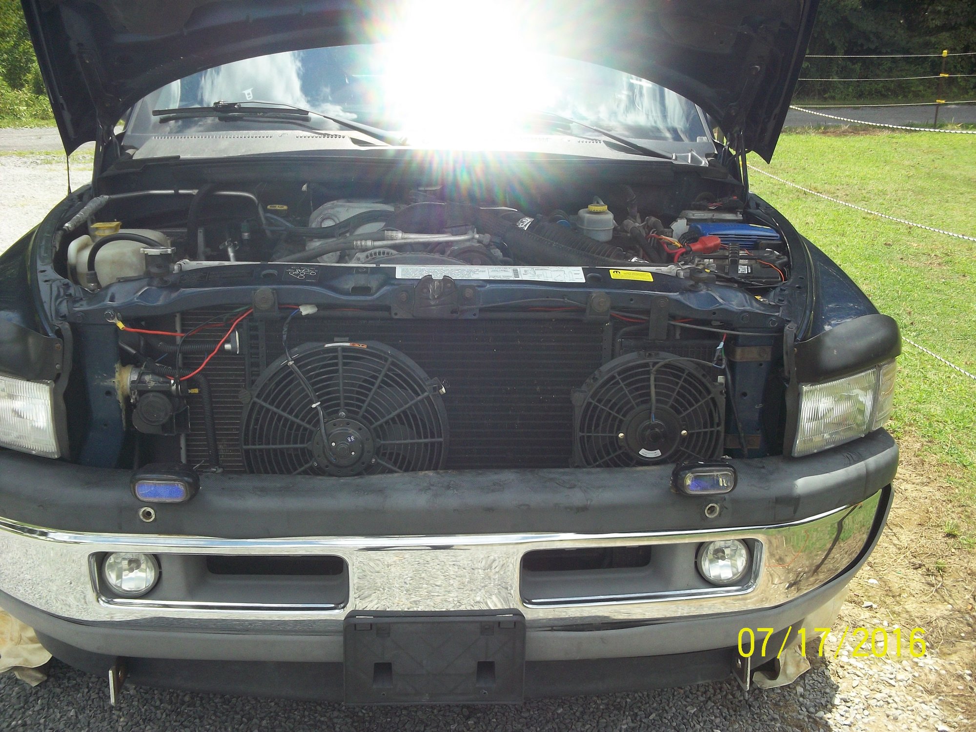

My 2000 V10 is stock. Well I replaced the air filter with a cleanable oil fiber filter - it might breath a little better. Was thinking about doing some kind of mod to the air intake box to get more flow.. but it runs great for me.
Did replace the water thermostat with a 190 might be 185.. but it runs cooler. I added two pusher fans : a 12inch in front of the AC / Rad and . a 10 inch in front of the transmission cooler. They are wired to a manual switch/relay both run together.. Helps some with the long loaded pulls. I did replace the stock fan thermo drive - the old one failed to engage.
I run 87 oct gas when not pulling and 89 with the trailer. If the mix is not 'right' I run 91 big $$ but as long as it runs with 89 I save some.
I get about 12 no load and 8 to 10 with the trailer. (GCW 18500) not fully loaded
I think for the most part ,this engine is set up OK for what I use it for, pulling the horse trailer. Runs strong and never ran out of power to pull the 7% 3 mile grade up to my place.

How did you fit a fan in front of the tranny cooler, do you have pics?

Not sure I cab post a pic - the fan is just the normal add-on cooler fan
Hey it worked !

Ah that's where I was confused the V10s have a different setup then the v8s lol
