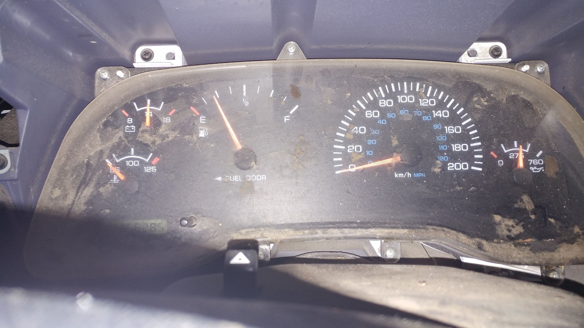

Idk how high it revs because I dont have an rpm guage but its definitely reving up but the truck wont drive forward or in reverse unless it's in 4 high and that's barely moving to the point I can walk faster
