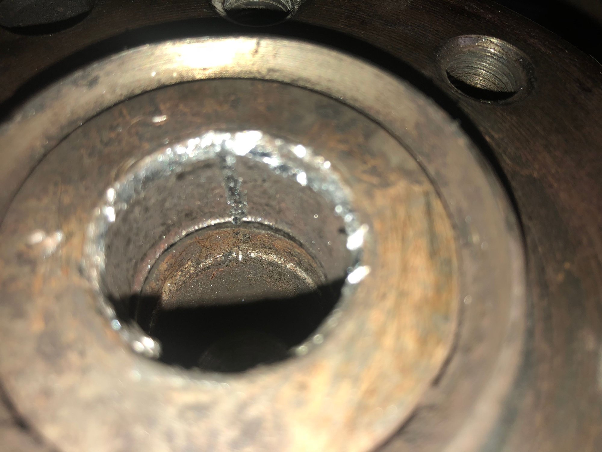

Laying under the truck right now, at a loss. Whatever the hell is in the end of this crank won’t budge. I can’t even tell what’s bearing and crank at this point. I’ve been trying to get it peeled off one side so I can pull it out but it just breaks off.

Looks like the outer bearing race....... What's left of it, that's gonna be some fun. Hardened steel, it's not gonna bend, it's gonna chip off. That's where I use my Dremel and split it with a cutting disc, have to go at an angle, it won't make a straight cut. New disc and start on the inside, worn disc won't reach the back. Puller won't help either I don't think there is enough for it to grab a hold of. Out of the whole clutch change I think the pilot bearing is the worst. All my wife and I own are straight drives, lol. My truck, her nitro, and her gt500 that is due for a clutch......... About $1,600 worth of clutch kit lol.

Nope, that's the bushing. The pilot bearing itself is only about 1/8" thick and can slide onto your ring finger (yours appears missing). It goes in the center there where you have the void. The shiny center is actually the back of the crankshaft.
My late friend helped me with this trick to remove the bushing:
Drill 3/8" or 1/4" holes in the bushing carefully from top to bottom and side to side. This removes enough material that the bushing - aka hunk of steel - will have less contact and pressure on the crank and can be removed. After we drilled (mangled it) mine came right out. We then seated the new bushing with a block of wood and hammer, followed by the tiny pilot bearing. Glob it with grease and move on to the clutch.

The dremel tool did the trick, finally got that cursed bearing race out. I cleaned out the hole and aside from some cut marks and mangling on the outer rim it felt fine and should easily accept a bearing. However, the needle bearing they gave me weeble wobbles around in the hole. It fits decent on the shaft, could be tighter though. I’ve heard that needle bearings are not a good way to go, they don’t last with all the dust and eat your input shaft? Should I find an oillite bushing and if it’s the same fit maybe center punch the OD of it?
