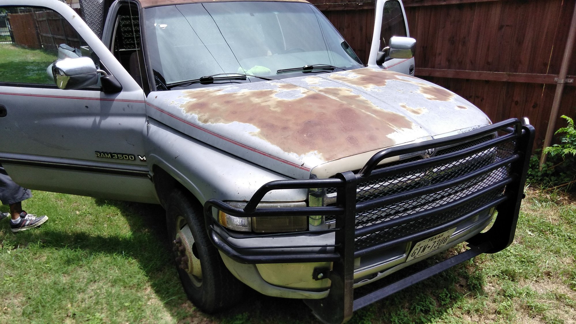

Hey guys,
I know it's been awhile since I've been around, but I've been lurking in the shadows, as I do.
I have come across something kind of interesting.
I have recently started having the dreaded transmission slip and I know my tranny is about to bite the big one. After pricing transmissions and pricing a rebuild I started hunting around to see if I could find something else that will get me by until I could rebuild the transmission and motor both in my 97.
That's when I ran across a 95 3500 Dually with a V10 and 5-speed.
Of course it's a 95 so it's going to have issues but I'm looking at it for two things.
1.) I need it to work long enough to get by while I'm rebuilding my transmission and motor in my 97
And
2.) From what I read so far, I would also like to rebuild the motor and the rear end in it and keep it around to use it to expand my moving and delivery business I own.
The main thing that I am wondering is, are there any known severe, expensive issues that I need to know about?
I am a bit concerned about the black above the exhaust in the rear.
Keep in mind, I've talked to the guy down taking $1,000 for it. (Apparently his wife is pissed about having 3 trucks in the drive and 4 in the yard behind the house.......)
I know it doesn't look the greatest, but that's easily fixed.
Old Jun 18, 2019 | 09:18 AM
Posts: 87,397
Likes: 4,213
Nice to "see" you again.
The 8.0 is actually a pretty reliable motor, mechanically. I regularly see them with well north of 200K miles on them, still running just fine. The problem becomes, some electrical parts are becoming EXTREMELY difficult to find. Coil packs, various sensors, etc. Some folks have converted them to use the newer OBDI coils and sensors..... but, that is a bit of an exercise.... Aside from that, no real major issues.
