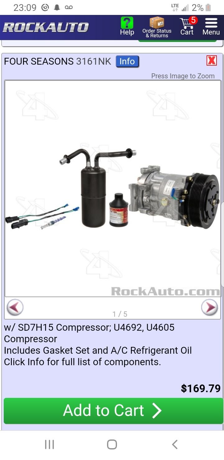

I like this brand and kit:
I do recommend having a shop refill it as you need a certain amount of oil and refrigerate in the system.
