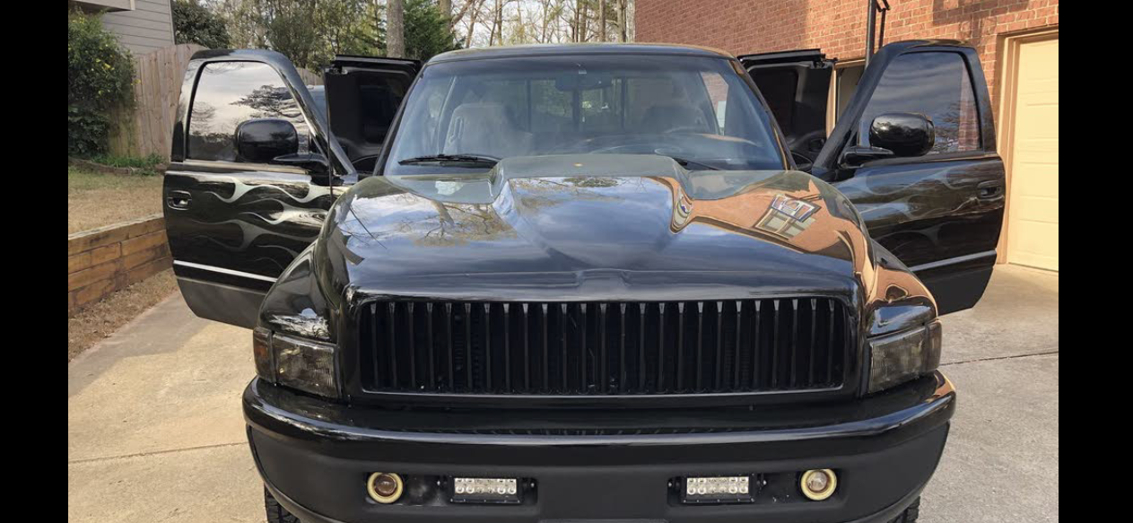

Picked up a new ride last weekend. 98 4X4 5.9, Auto, 171k, rebuilt tranny Well taken care of, the PO added a backup camera, remote start, Bluetooth stereo, sub inside rear seat console etc...The PO had paperwork where he had work done to the rear end. He had new ring and pinion, axel seals and bearings. I traveled about 270 miles to pick it up and on the way home, i could hear a whine from what sounds like the rear end. It is quiet when off the gas, makes a whine when on the gas, and louder if I give it more gas. I assume from reading here that the shop probably did not setup the gear set properly. Anyone have any input? Change to a different gear lube to maybe quiet it down? Work was done over a year ago, so it should not be any type of break in issue, it that is even a thing. Also, truck would shake, mainly between 60-70 on the way home, not excessive, but definitely not smooth. Seemed to shake more often than not at those speeds. With the cruise on, it would be fine, then just start shaking. At first I was thinking tire balance, but then thinking maybe transmission mount. I could not feel the shaking through the steering wheel at all, so probably not a front end issue? It is not a misfire shake, engine is smooth. BTW, my headlights really suck, they look cool, but don't light up the road very well, they are tinted so I am sure that can't help, but are there any bulb recommendation I could try to brighten them up?
