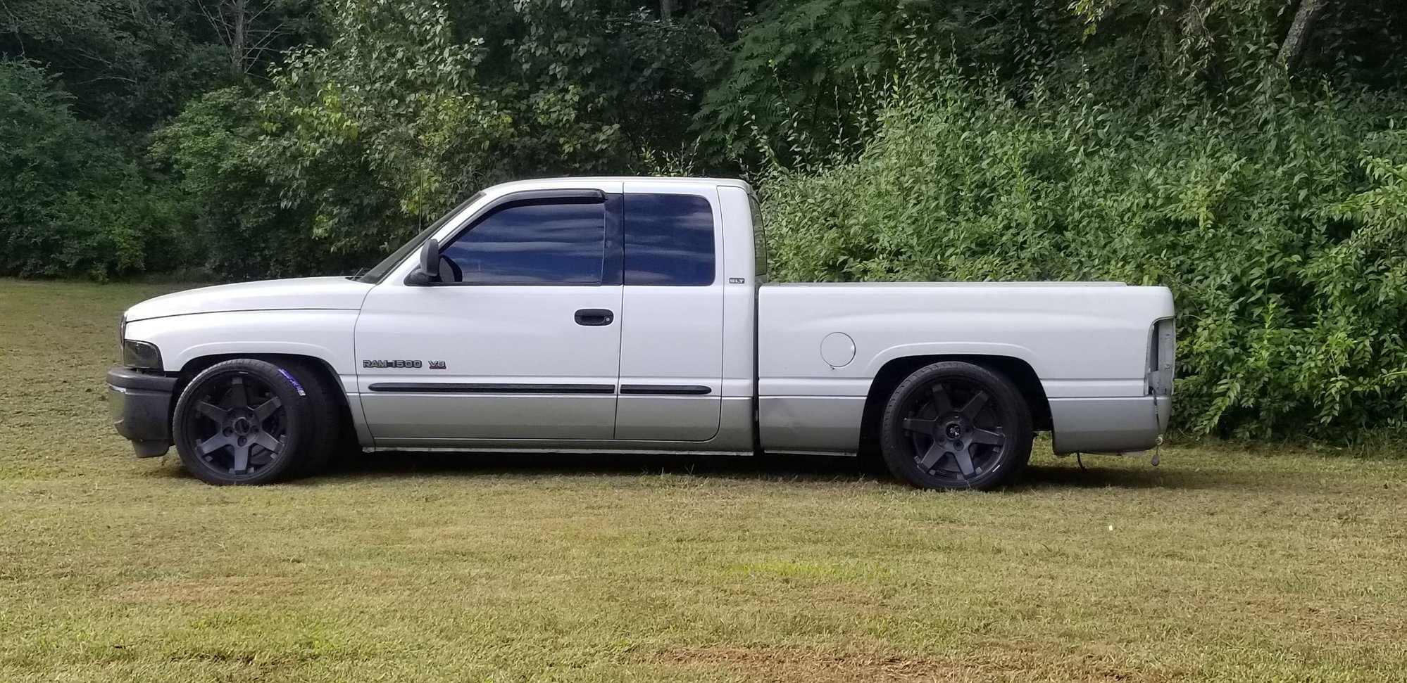

Does any know if the 99 ram drop spindles will work on my 01

I don't think so. I believe the brake caliper mounts changed in 00.

How about the trans crossmember for lowered trucks is 99s diff than 01 or are they the same cuz that's another one I cant find its either 94 to 99 or 2002 and up like 2000 and 2001 dont exist

Engines transmissions and frames were the same, I really can't see a reason why they would be different.... But, that doesn't mean they aren't. Any junkyards nearby with some dodges you can investigate? Crawling around under folks trucks in parking lots probably wouldn't be a good idea. (maybe ask first. )

Cross members are the same. You need a 2000 and up spindle
