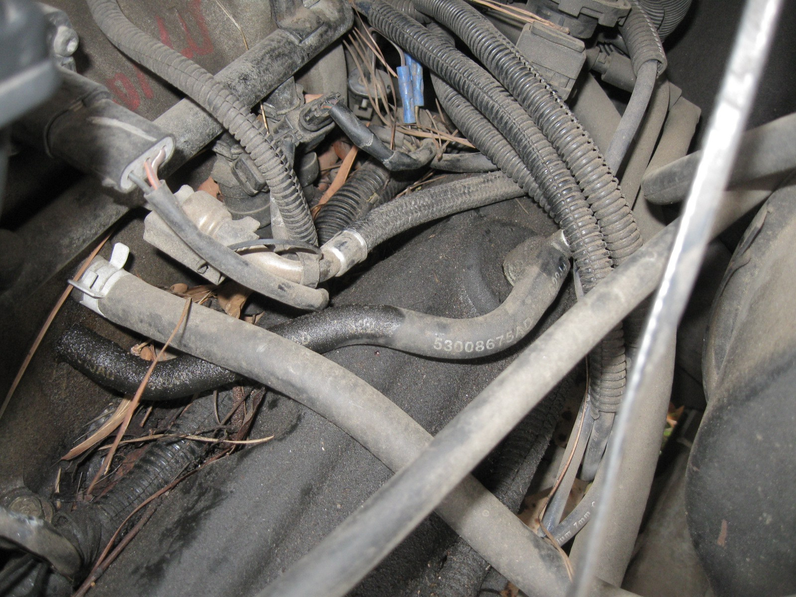

I was wondering if anyone knew where I could buy a factory or close to factory PCV hose for the driver side PCV. Its the one in the center with the numbers on it.

If you type in that number you’ll find it. Here’s amazon

Or just get some fuel or transmission hose.

Any auto parts store will have it.

I had the same issue last week. I replaced my PCV and grommet and found that the hose was split. I went to O'rileys, took my old hose off and they matched up some fuel line the same size for $2.16.
It is discontinued most places I have looked, but if you really want the pre-formed hose, I think CARiD was the only place that said they have one, I just didn't want to wait for shipping. I think that hose was $8 and some change.
