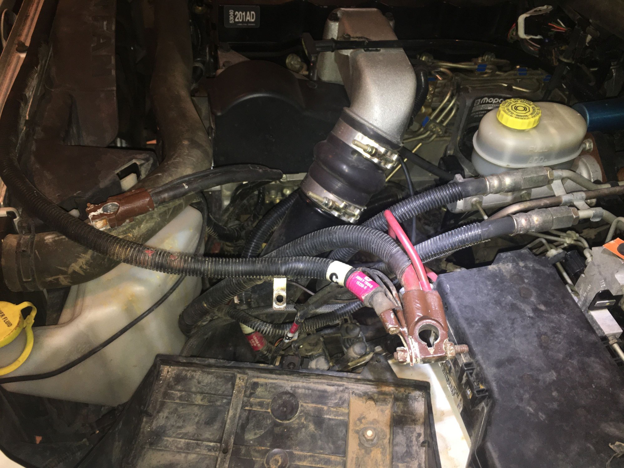

Really appreciate your help, I ordered a new switch that has the fog light function (pull out), am struggling with finding a harness with a dealership, many options on eBay but am not 100% sure the part will be correct. Here is a picture of my firewall where there is an open connector, I have no idea if this is for a connection to the fog lamps, I am missing a relay in the fuse box, my local dealership is of no help with finding this relay.
Do you know whether or not the connector in this image might be for the fog lamps?
Lots of other wires leading toward the radiator area but am not seeing anything that might resemble a connector for the fog lights.

Check from the manual that do those wire colors march with the fog lamp circuit, but I think it does not.
That relay should be available on any parts store, it's not anything dealer specific.
