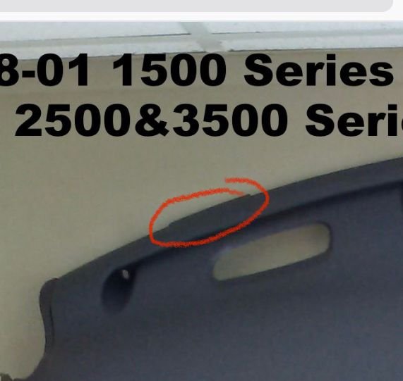

The tag on the front edge of the dash (where the VIN tag rivets) can just be seen in this pic.

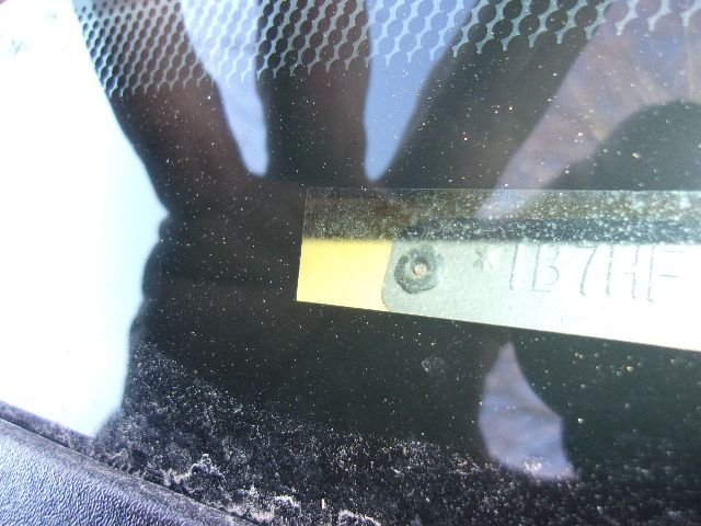

in YOUR pic you circle the vin tag to show the tag attached to the dash. if it were directly attached to the dash the vin tag should be centered in the dash window at all times, how can it move from the center of the vin tag window in the dash? to get this pic view this dash would have to be broken. and better yet, why is there a vin tag window in the dash if the vin tag were attached to the dash?
in my pic you can easily see body color next to the tag. in my experience this tells me it's attached to the body. if it were attached to the dash or frame you would see the dash color next to the tag.

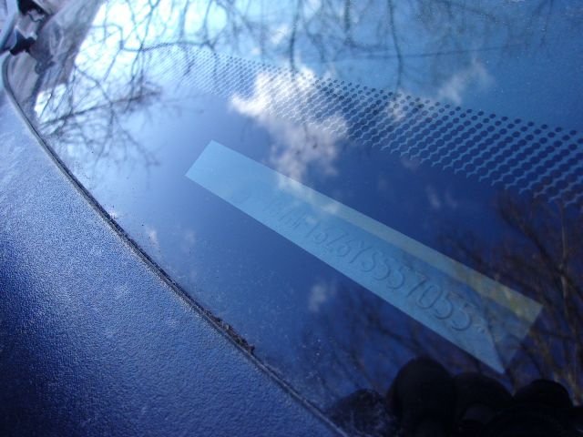

My 1995 has tag riveted to a dash. And as it can be seen, dash is cracked and the other rivet has fallen off making the tag rattle very annoyingly.

yes it looks like yours is riveted to the dash. you can see dash color next to the tag.
the pic i posted is from my car a 2000 and the tag definitely looks to me like it's riveted to the body from the body color next to the tag.

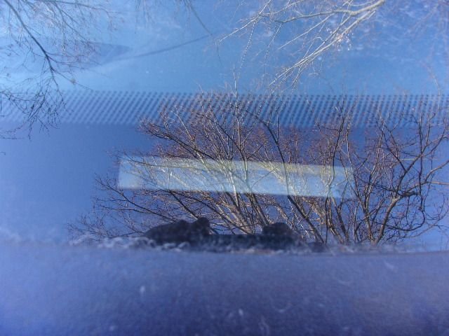

here is another pic of my 2000 tag. you can easily see body color on the outer end of the tag. if it were on the dash it would have dash color next to the tag, my dash is dark gray.
compare the two pics and you can easily see the difference. even the windshield shading is different between the two trucks.
also notice how much closer the tag is to the bottom of the windshield, also notice how high the windshield shading is in my pic in my pic compared to the 95 tag pic.

I changed the windshield back in 2013, though the previous was glass looked same IIRC. Found picture from that time, which shows that there is nothing else than brittle plastic under the tag. Wonder why I didn't use the windshield adhesive to secure the flapping tag, would've cured the rattle problem once and for all...
