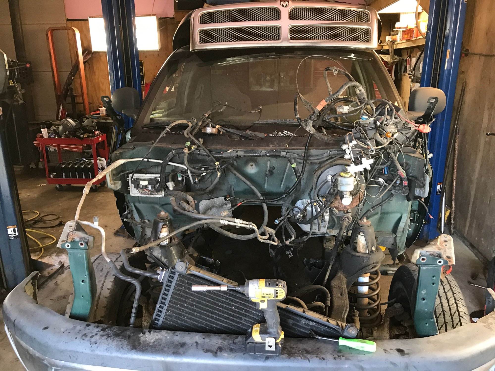

Hey everyone! I’m swapping a 2001 ram 1500 cab onto my 98 chassis and noticed while getting ready to take the cab off after taking off all the harnesses that’s there are different plugs for the injectors, alternator, starter, and also the plugs at the drivers side bottom part of the cab that runs to the rear of the frame as there is 2 plugs on my 98 and only 1 plug on the 2001. My question is it possible to just swap the computer and harness from my 98 to the 2001 cab with much having to be changed or am I creating a wiring issue if I do that. The harness that goes into the cab has the same 2 plugs at the junction for the interior can I get away with just plug and play? Why or why not. Any help with knowledge about this would be appreciated

98-1/2 there was lots of changes.
So vehicles from the second half of the year can be bastards with leftover bits from 98’s.
I believe 5/31/98 is when the last of the 98’s was built... beyond that is 98-1/2.
Check the wiring diagrams for both to compare.

You will need EVERYTHING from the 98 and use in the 01. Everything changed from where wires go to more advanced electrictronics
