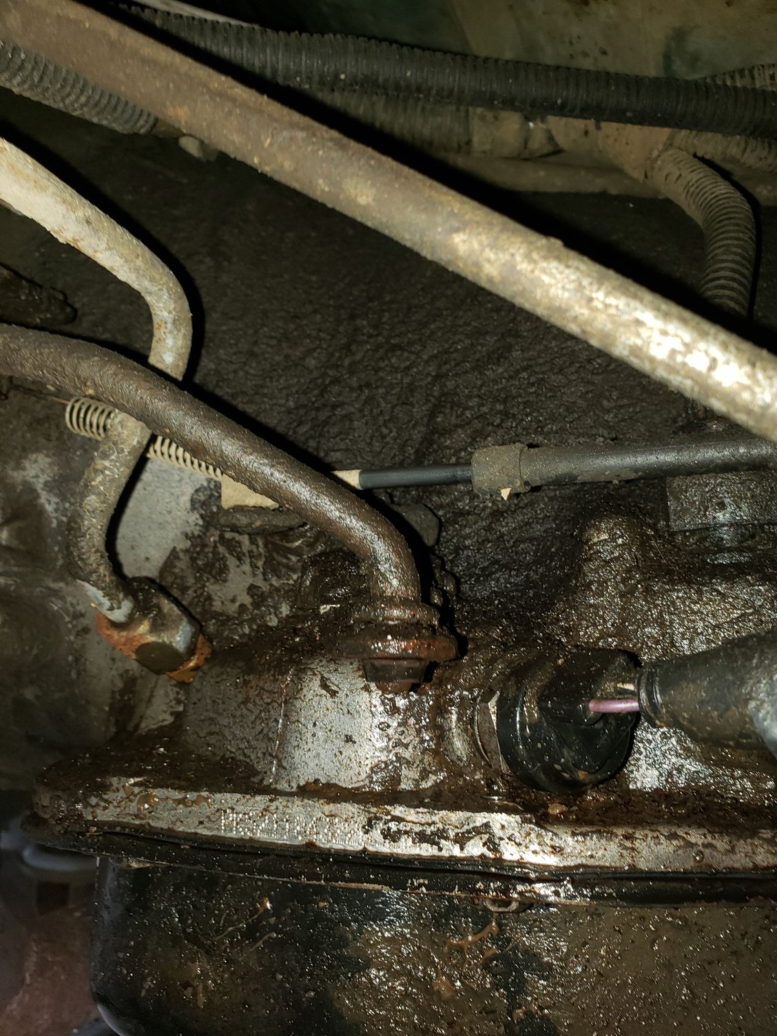

Hey guys
I finished dropping and reinstalling my valve body in the trans. Had a nice fighting match with the shift linkage that connects to the top of the valve body and now I’m struggling to put it back on. The bottom portion doesn’t seem to want to slip back on and it’s difficult the get some grip to pry it back down.
can someone send me a pic of their linkage so I know how it’s supposed to look. I should of took a photo

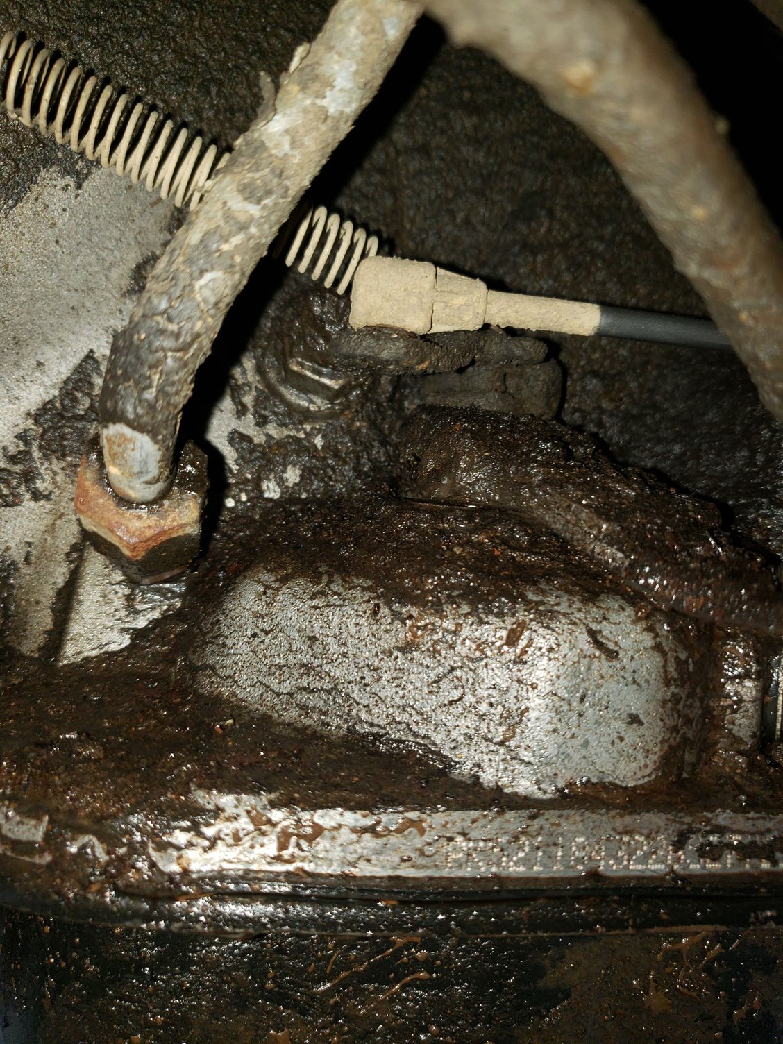

Originally Posted by zildjian3707
Hey guys
Best I can give you.
