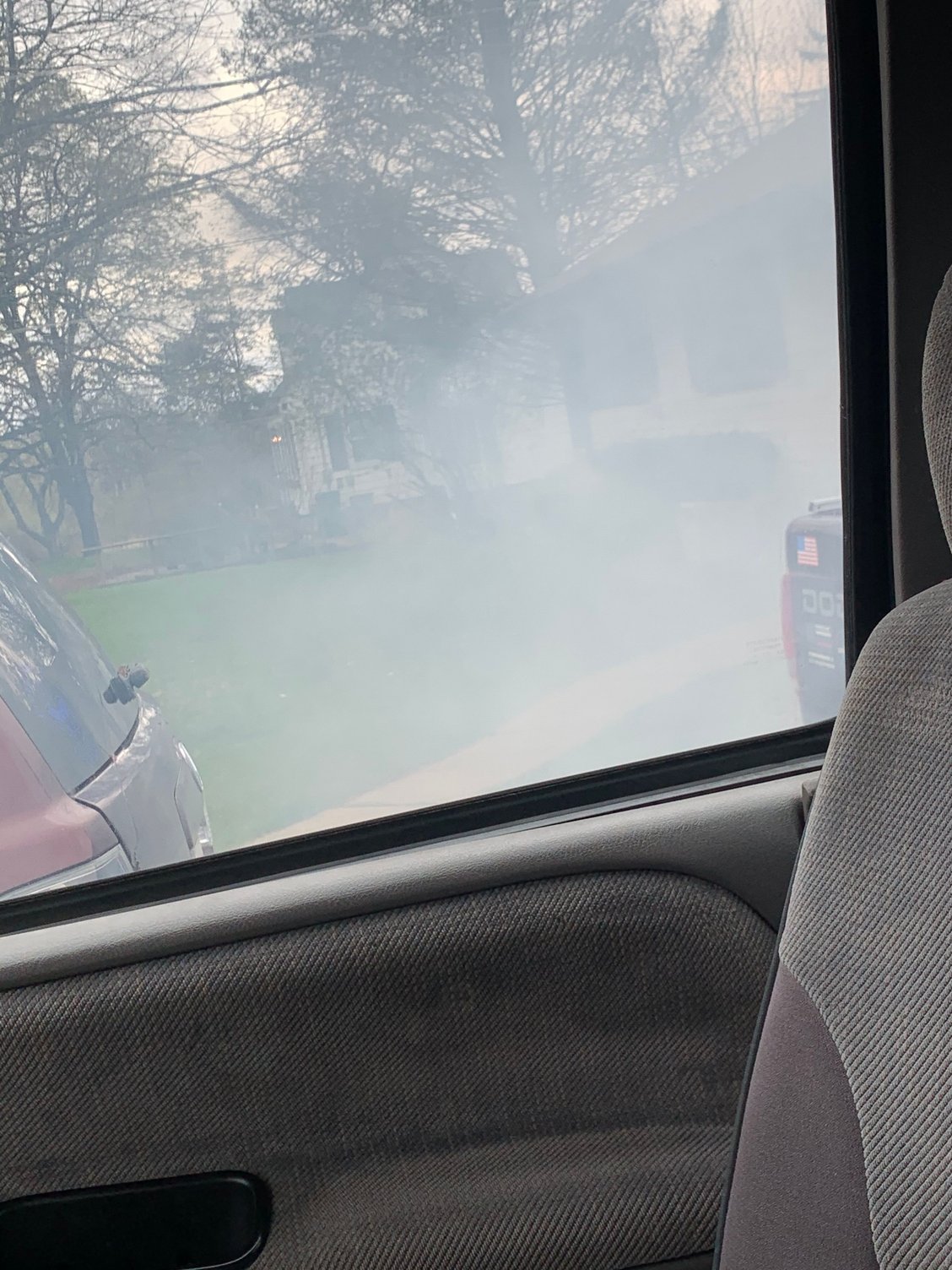

I tried 2 new crank sensors and reset the pcm both times and same problem, truck hardly crawls and if you touch the gas it stalls. If I want to move the truck I have to let it idle forward or back because even taping the gas makes it stall
little note also, now there are a lot of fumes from the exhaust. A lot of whiteish gray smoke coming out the tale pipe

Old Apr 18, 2020 | 01:22 PM
MoparFanatic21's Avatar
MoparFanatic21
Veteran: Marine Corps
Joined: Nov 2014
Posts: 8,098
Likes: 318
White means you are burning coolant (head gasket usually)
Blue means you are burning oil (rings usually)
