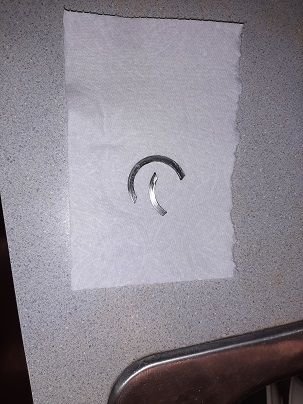

I tried recording the noise last night. You really can't hear it in the recording; just engine noise. I think the mic on the phone is too cheap as its easy to hear with my ears.
I plan on pulling the T-case output case to see if the bearing retainer snap ring is broken or loose. I'm told that can create this noise under load.

Default Think I found the problem...
Broken C-Clip on the output shaft of the transfer case. It sure sounded like a gear in the tranny. I hope to fix it this weekend.
Figures it would be one of the 3 items I did not rebuild.

You want to get "The Transfer Case Saver". It replaces that clip with a collar, that is MUCH more likely to stay in place.
Yep. I ordered the "Sonnex" version last night. It's a little cheaper and I might be out of work next week.
I plan to open the case Sat to see if there is more exstensive damage.
