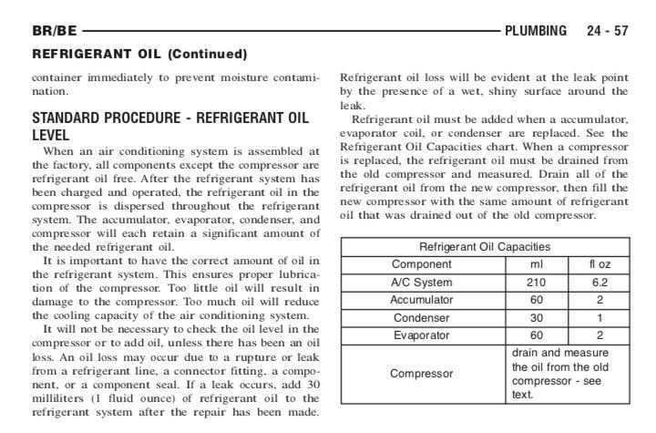

1999 Dodge Ram 2500 5.9L gas, I am replacing my Condenser, accumulator, and liquid line with orifice. How much Pag oil do I need to put into the condensor, the accumulator, and does the liquid line also need oil put in it ?

From the 2001 service manual:

You should replace the dryer also(any time the system is opened up) witch holds most of the oil. When you install everything add the oil to the dryer.
