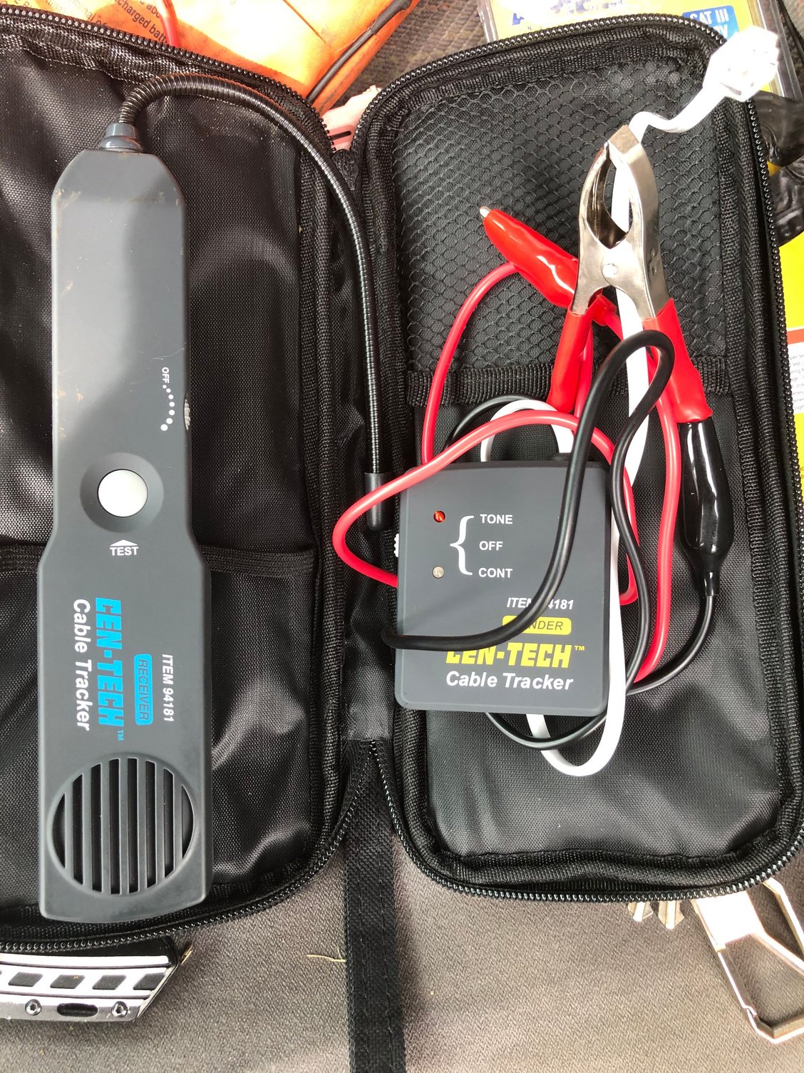

I proceeded to use the $25 cable tracer I bought from harbor freight to find the break in the wire (this woulda been a nice tool a couple days ago to have heh)
I found that the break in the wire is halfway from the cowl harness to the broken connector by the transmission (right behind the motor in the hardest to reach place LoL!)
next I think I’ll to splice into the brown white wire from the connector by the trans and by the connector under the cowl in theory this should bypass the broken wire and tell me if my CEL code is actually due to this. (Either way I know the wire is jacked up for sure)
