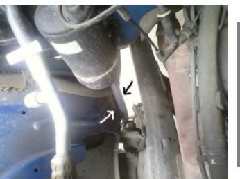

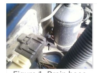

Any one know why I would have a coolant leak coming out of the climate control condenser drain tube? It’s not much but I’m still loosing coolant slowly and I have none on the floor board in the truck it’s just coming out the a/c drain tube?

That's just water from condensation like when you use AC then park it and it leaves a puddle. Someone smart put a hose on there which I did as well. If you're losing coolant (green) then you have a leak elsewhere.

The ac to the truck doesn’t work never have since I’ve got the truck and it’s coming out gold/ orange color which I use a ZEREX G05® 50/50 Coolant

Then most likely your heater core
