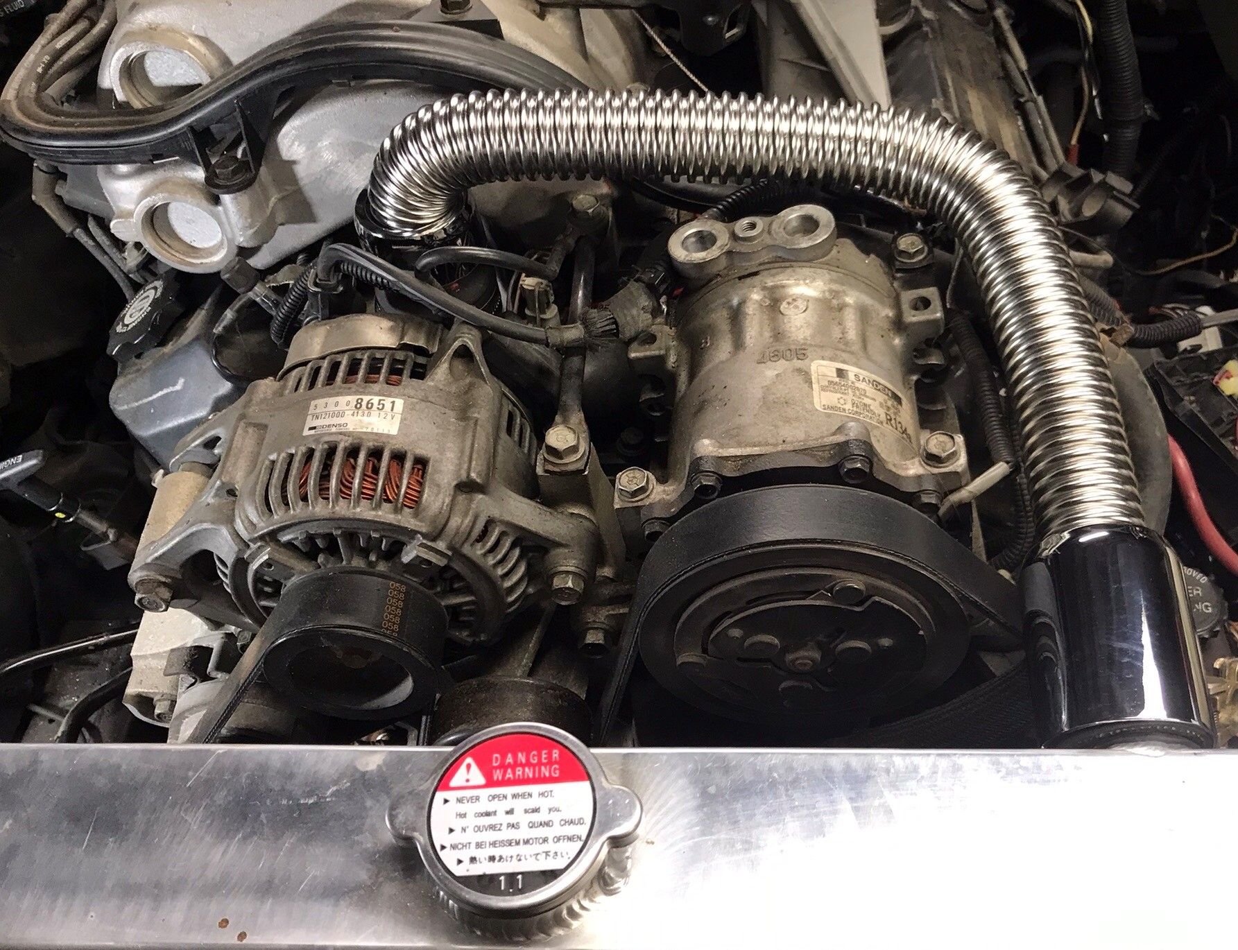

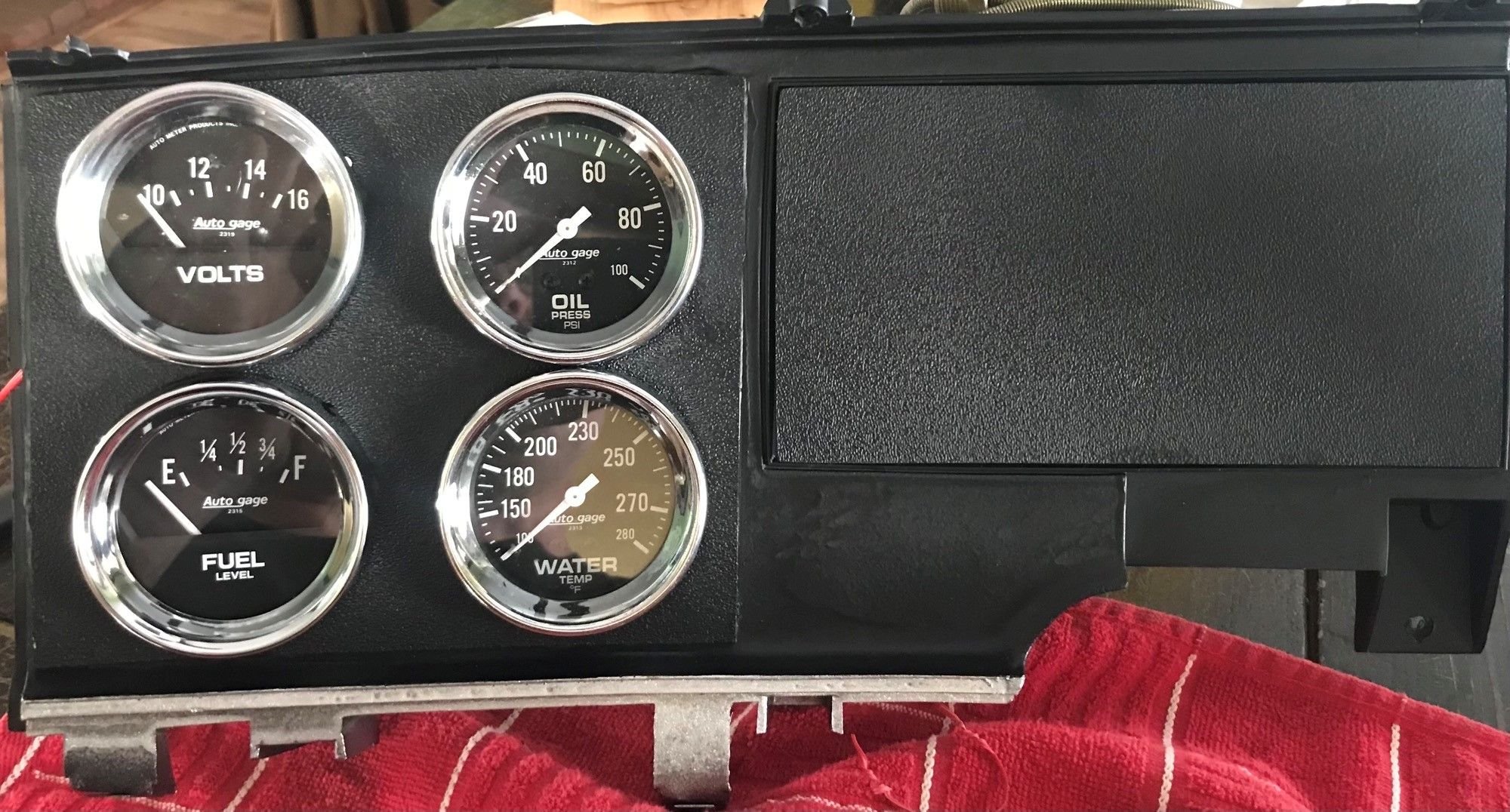

Made a little progress on the V10 swap. I made a custom gauge cluster so I could hook up my mechanical gauges and got the cooling system installed so I could run the engine up to operating temp. Still no exhaust so I don't have any O2 sensors hooked up. Exhaust and O2 sensors are my next project.
So when I started the engine my oil light went out and the mechanical gauge was reading about 25 PSI. As the engine warmed up to 180, 190 the oil pressure dropped to about 15 psi and the light started coming on. When I increased RPM to around 2500 rpm the oil lamp goes out and oil pressure gauge jumps to 55 - 60 PSI. I checked the service manual and is shows the spec of 12 to 25 at idle and 50 - 60 at 3000rpm so I think OK.
So my question; is the oil sensor going bad? I would think if the factory spec is as low as 12 psi then the lamp shouldn't come on till pressure is below that.

15psi seems to low to me. My v10 is about 30-40psi warm idle. Did you check the screws for the oil pump cover? They are known to back out and cause loss of oil pressure, even seized a few that dropped to 0psi while driving. The oil pump is built as part of the timing cover and the screws for the pump cover are on the back side. Quick peace of mind to just locktite them in, I did on mine when I did my cam and head work.
