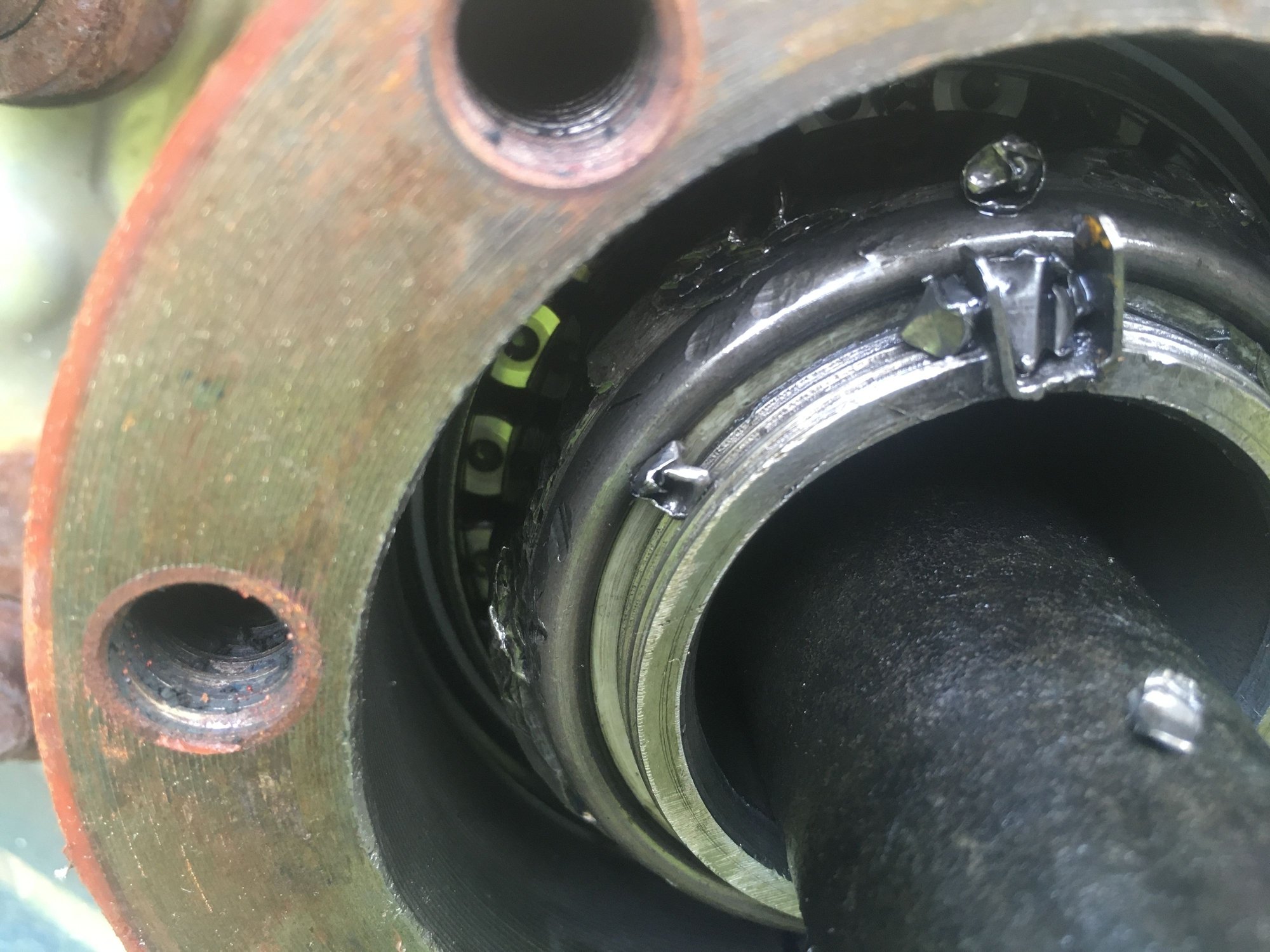

The driver side carrier bearing is shot. The rollers actually fell out on to the ground when I pulled the carrier. The inner race came off by hand. Probably need a new carrier too then.
The driver side wheel bearings will be replaced too. Something bad happened in here. The spindle nut has been beat on pretty hard by something. All the gears look fine though.

Where did those metal chunks come from in the wheel bearings???? That's not good.....

Has to be the drivers side wheel bearings, haven’t taken those out yet.
A lot of that is what looks like it was a bearing cage, which also came out when I took the cover off the middle. The cages in the middle were all intact.
