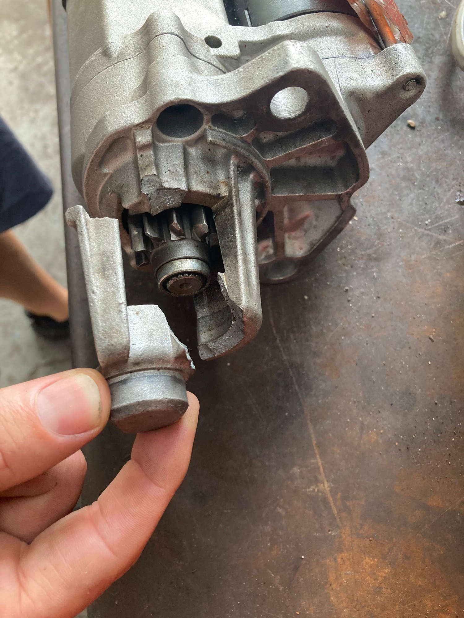

hi i recently found that this truck i bought which is a 5.9 magnum 2001 extended cab automatic trans has a loud knocking noise coming from in between the flex plate and the torque converter i will post a video so you can hear it for your self the knocking is the worst in reverse and the quietest in neutral, the pitch of the noise changes when i switch between any gear, so what i did was pull the trans because i thought it was the flexplate which looks fine to me no bending or anything like that, then i had a look at the TC and it has a knock in one spot of the full rotation so im thinking its a transmission issue now because when i was pulling the trans the 2 of the bellhousing bolts were missing and the others were pretty lose. https://imgur.com/a/VHeKLyR

there is a audio button in the top right of the video and what originally i thought happened was the starter because the idiot that i bought the truck from chose to cut corners on everything he did i guess because the starter had 1 bolt threaded and tight and the other bolt was the wrong tread and was loose and what happened was i pulled the starter because i thought the TC was hitting it and sure enough the snot got broken off by the TC so i thought that putting a new starter in would fix it but nope something else is the issue here
