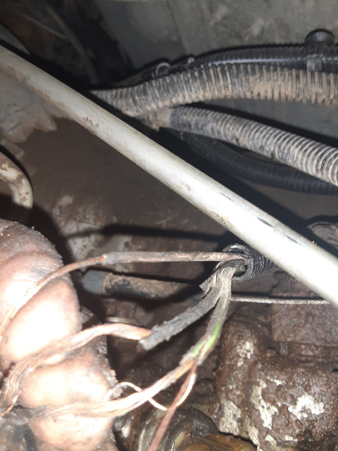

Just turning the key to on position and #7 fuse blows.
From what I can find so far is that there are three circuits or switches on that fuse:
1-park/neutral safety switch
2-back up lamp switch
3-DRL module (though I am not sure if my 2001 has drls... never have seen them)
Any trouble shooting tips appreciappreciated, thanks.
Malted insulation more than 2\" up wires.
There it is...wiring insulation gone!
Following the repair the back up lights work again as well as starting only in park and neutral.
AND THE CRUISE CONTROL!
So even though there may not be a dedicated fuse for cruise control if #7 dash fuse is blown cruise control will not engage.

Grab the service manual for your truck from here. (if you don't already have one...) Wiring diagrams are in section 8W.
You apparently have a dead short somewhere. Shouldn't be *too* difficult to find.

Actually the park/neutral safety switch is also the backup lamp switch on automatics, the backup lamp switch in the wiring diagram is only found on manual transmissions. One of those things that throws people off. Unless it's a Canadian market truck it won't have DRLs, AFAIK US trucks never had that option.
