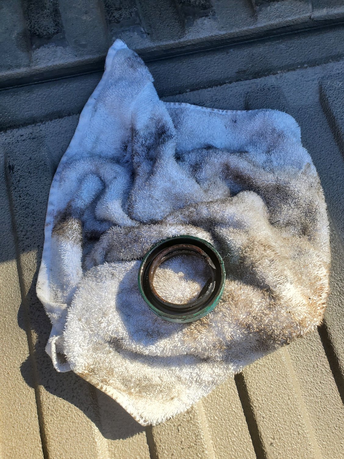

Took me about 40 minutes this morning
Old Sep 30, 2021 | 01:59 PM
  #30
AtomicDog's Avatar
AtomicDog
Joined: Sep 2012
Posts: 4,868
Likes: 434
From: Central VA
Congratulations!
