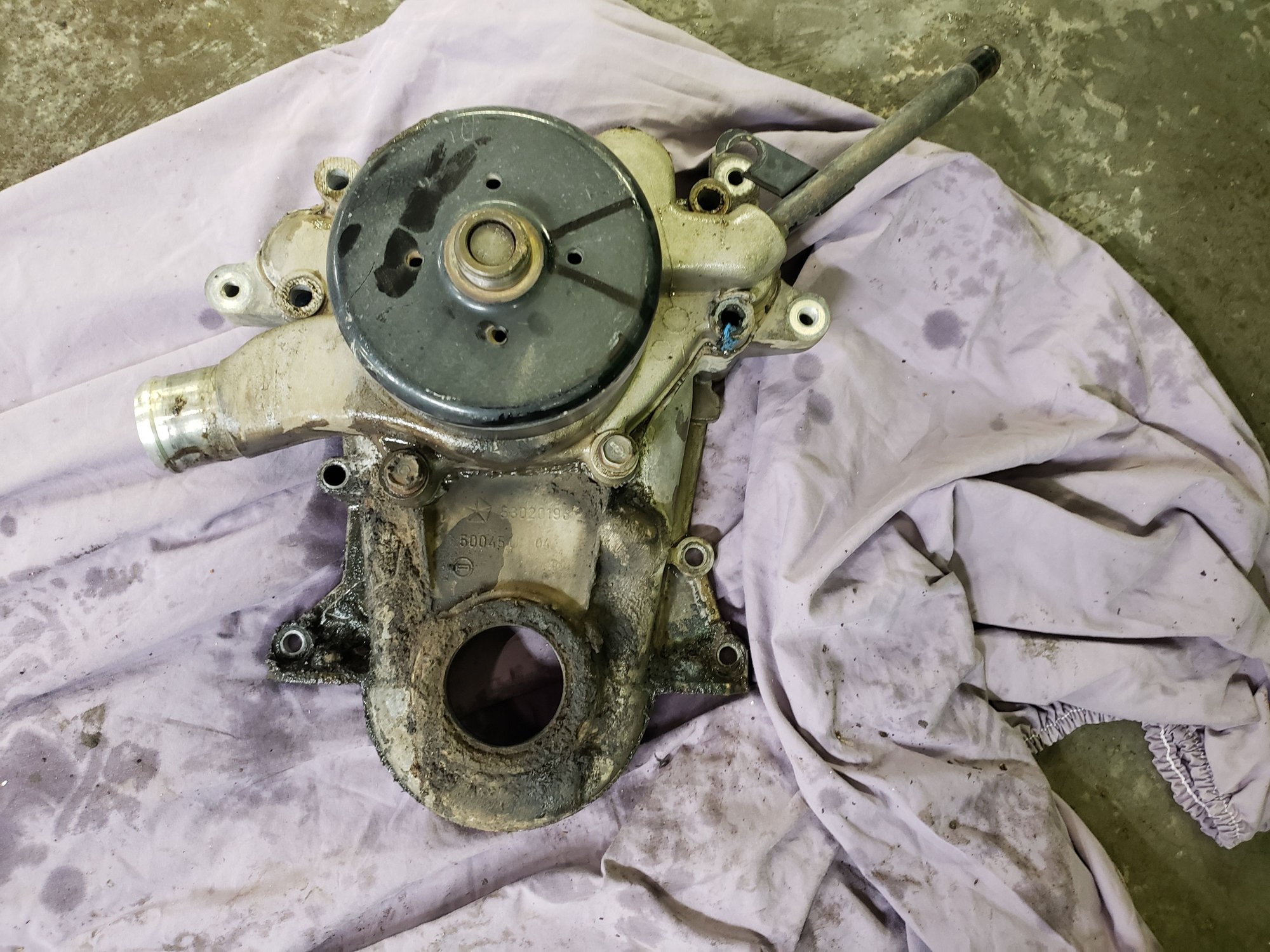

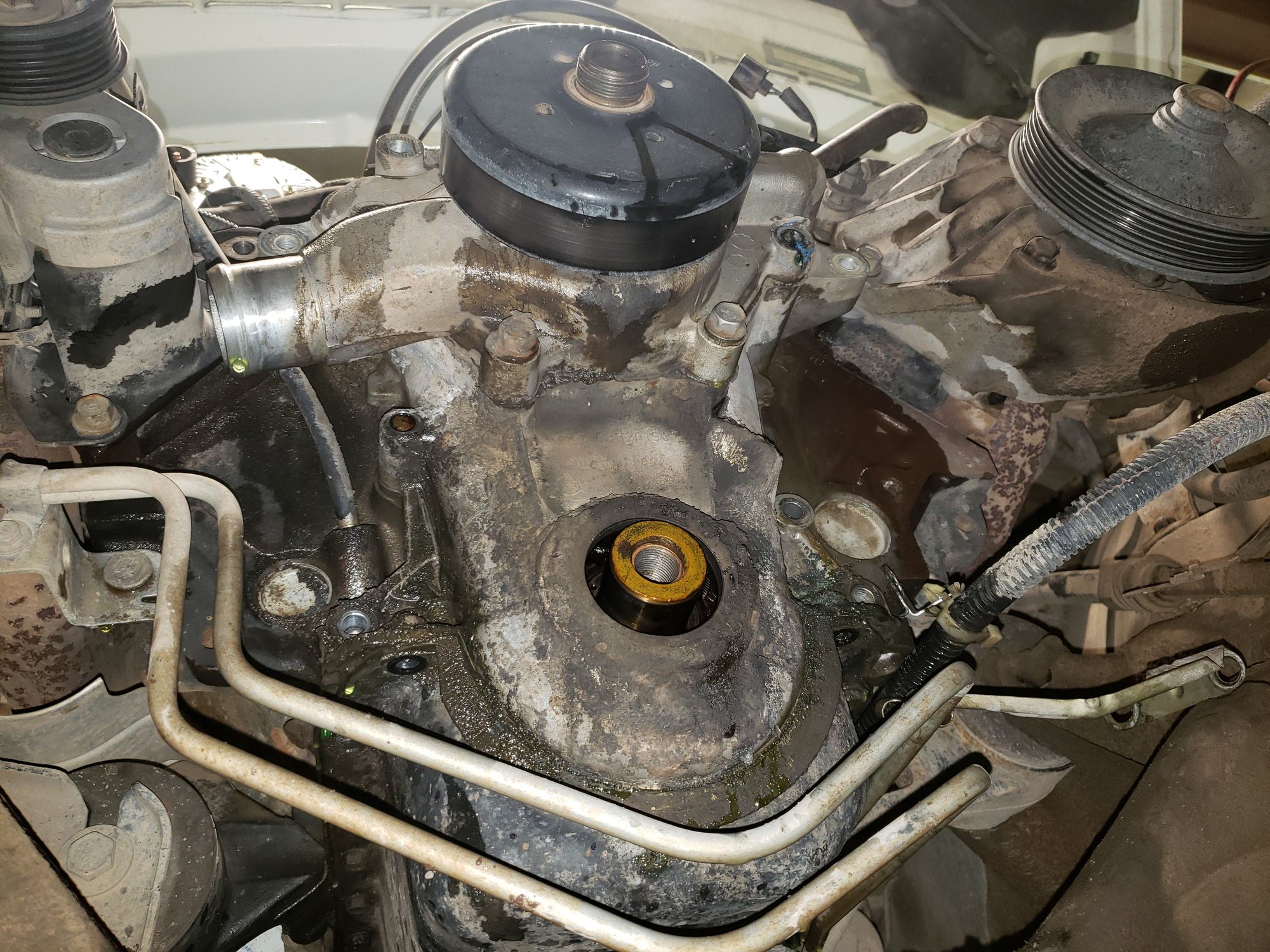

This is what you're facing if you opt to leave the wp. I dunno, doesn't look too scary to me?
Done. I didn't encounter any drama but maybe I just don't like drama. Seems to me the weep hole would be just as (in)visible as if the pump were removed, but my contacts are -9.50 so it could just be my crappy eyesight

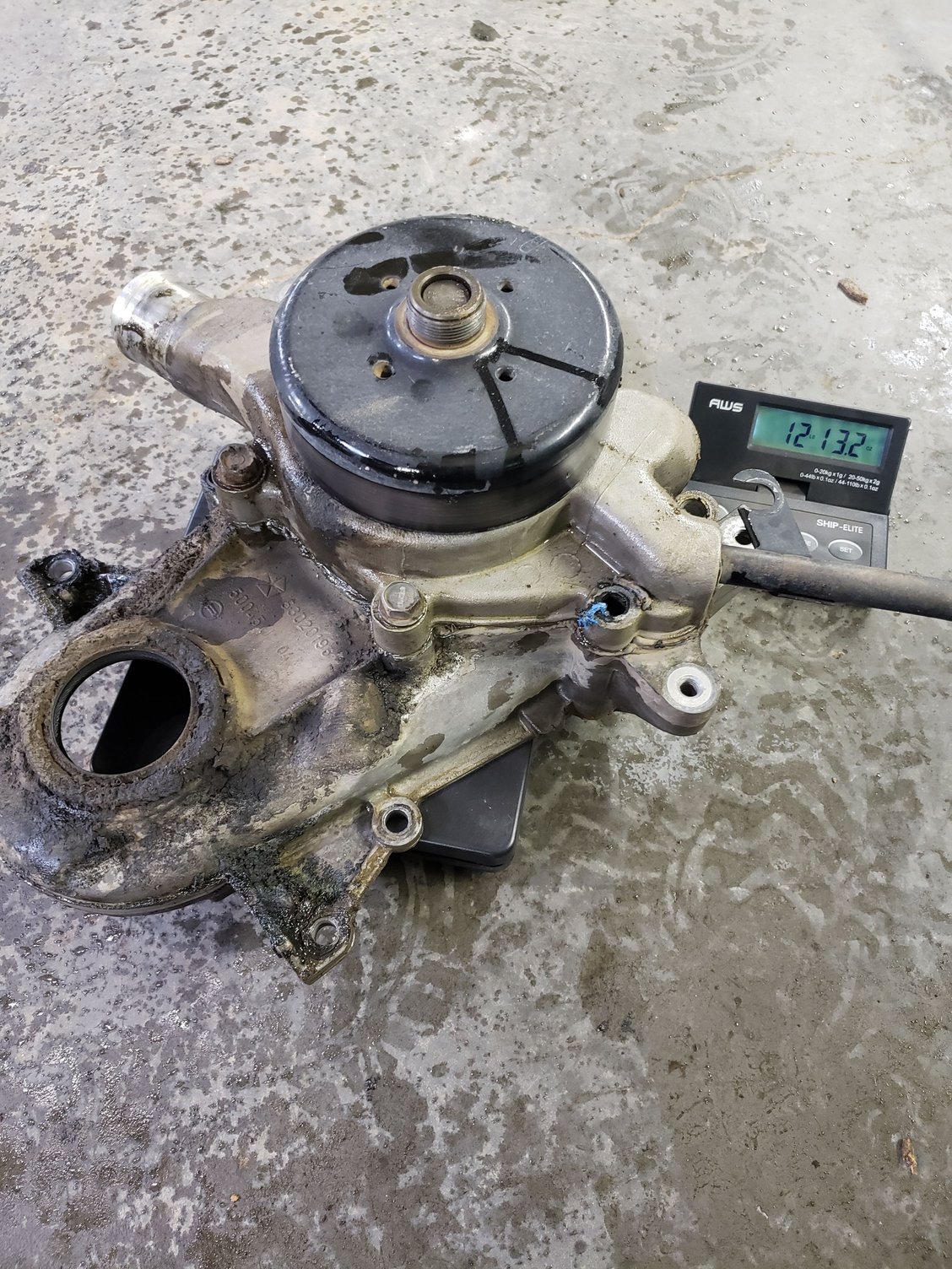

From what I can tell, the only argument in this thread that might hold water (pun for sure) is concern about leaks after disturbing 4 of 7 wp bolts:
A few ounces under 13 lbs. Didn’t strike me as heavy and I'm not exactly a "tough guy"

I always clean and paint parts I pull. It just makes for a neater repair and with the pump on, it looks like you may have trouble changing the front seal. I believe your pulley will come off, either it pops off or unscrews. You should be able to see the weep hole when it's off.

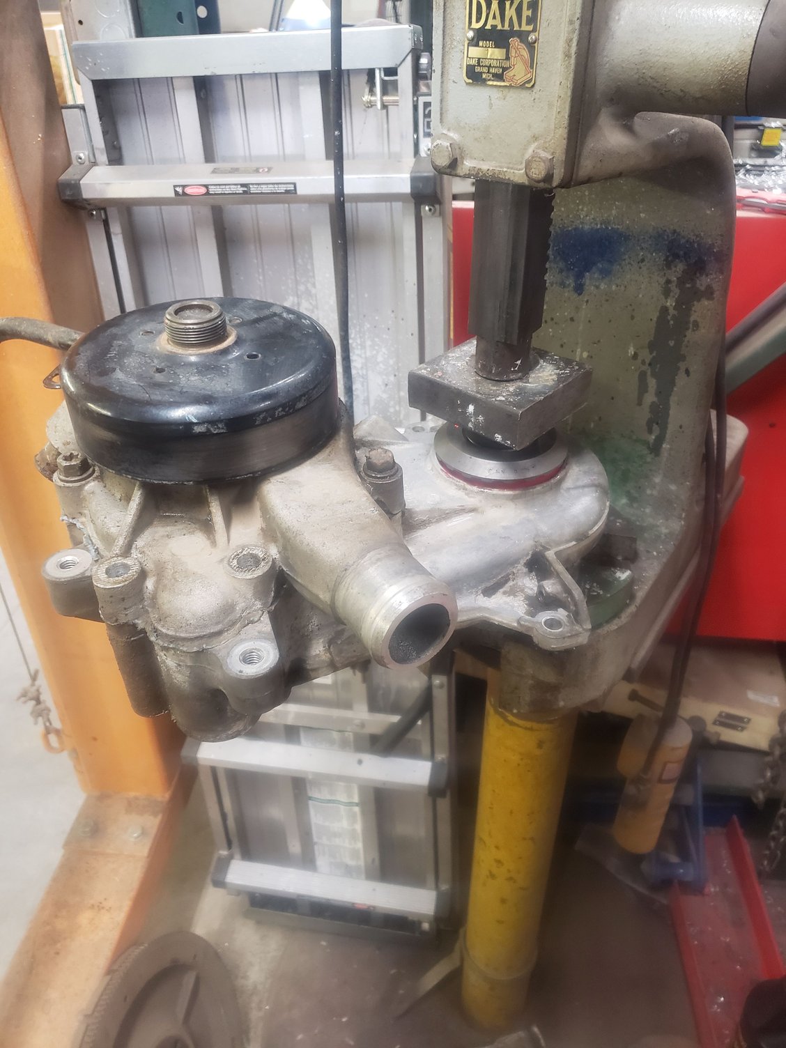

New seal pressed in easily with the Dake
