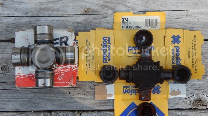

I'd personally only put a 5-760X in there, don't just accept whatever garbage the parts store has on the shelf
I can detest to that! This is what chepo u joints look like after about a year and a half. The spicers have been in there for the last 20 years!
