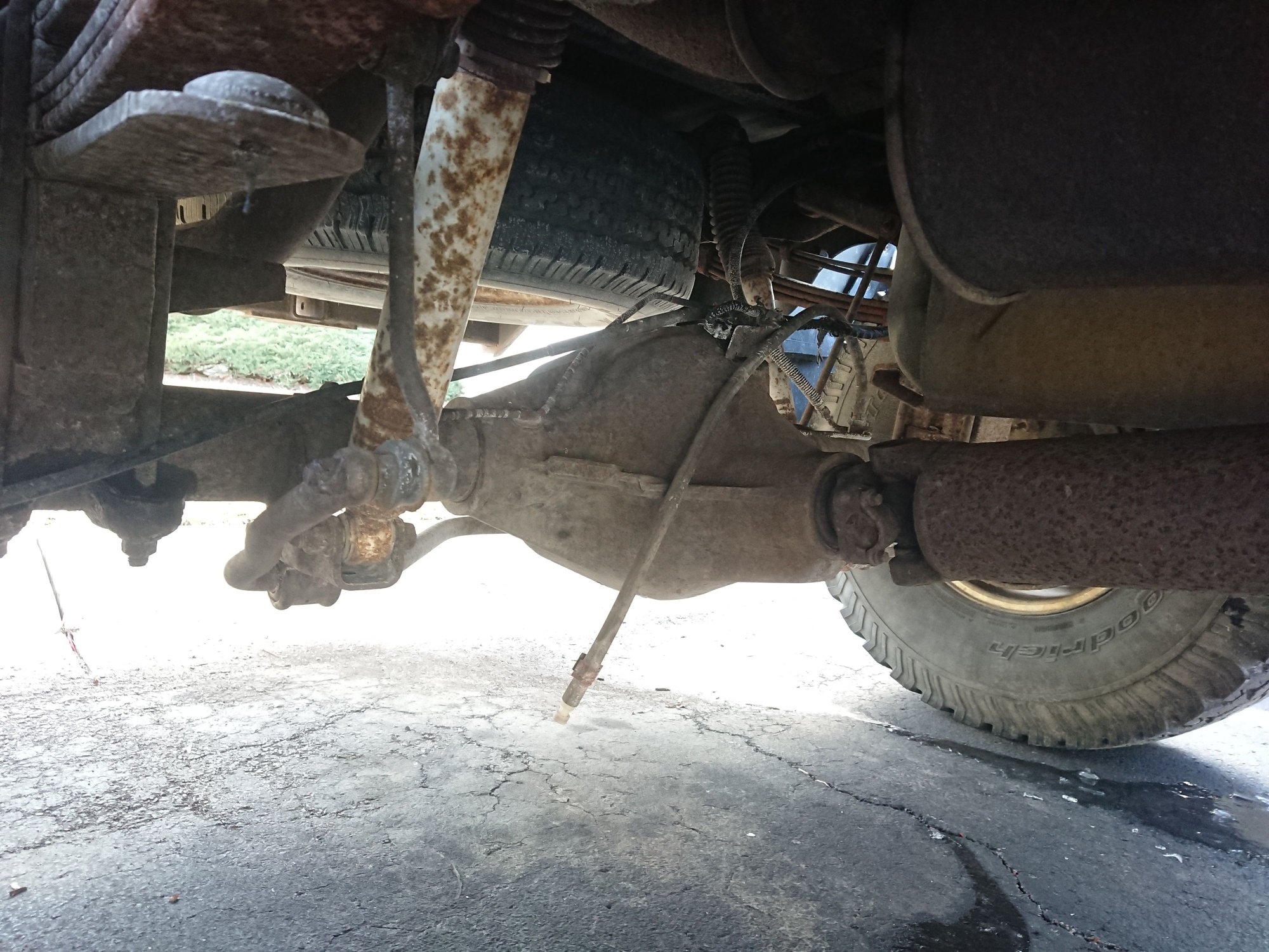

Any idea how this is meant to connect and if it's the cause of any of my problems? Hopefully you can see the disconnected cable in the photo.
This car is new to me so I don't know if this has been like this for a while or if it's new.

That's just your breather. Supposed to clip up to the frame. Wouldn't cause any codes or problems

Yes, the photo of the hose is of the vent for the rear axle assembly. You can affix it back up on the frame and all would be well.
