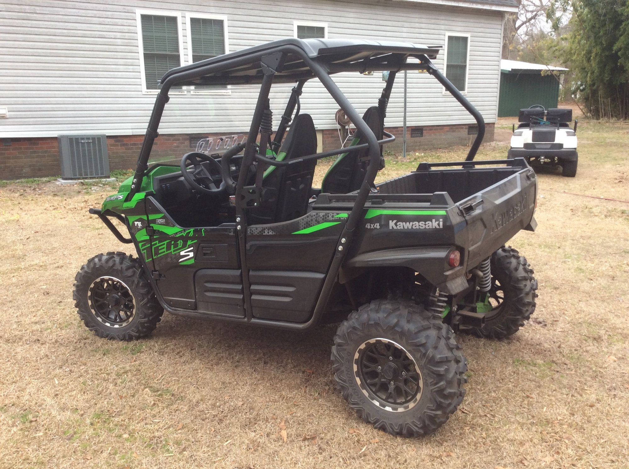

Recently bought a new Kawasaki Teryx 800 SLE. I’ve owned ATVs for many years, but this is my first side by side. Have friends who go to Hatfield-McCoy regularly, but it will be a first for me.
