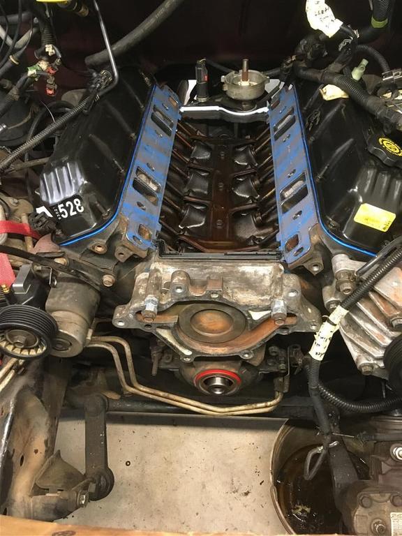

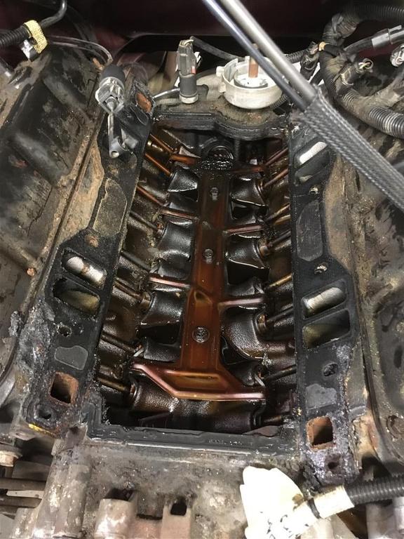

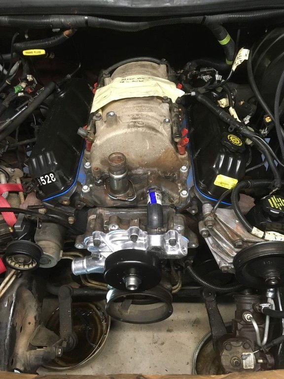

The cause
Plenum after removal
New chain
Mostly back together

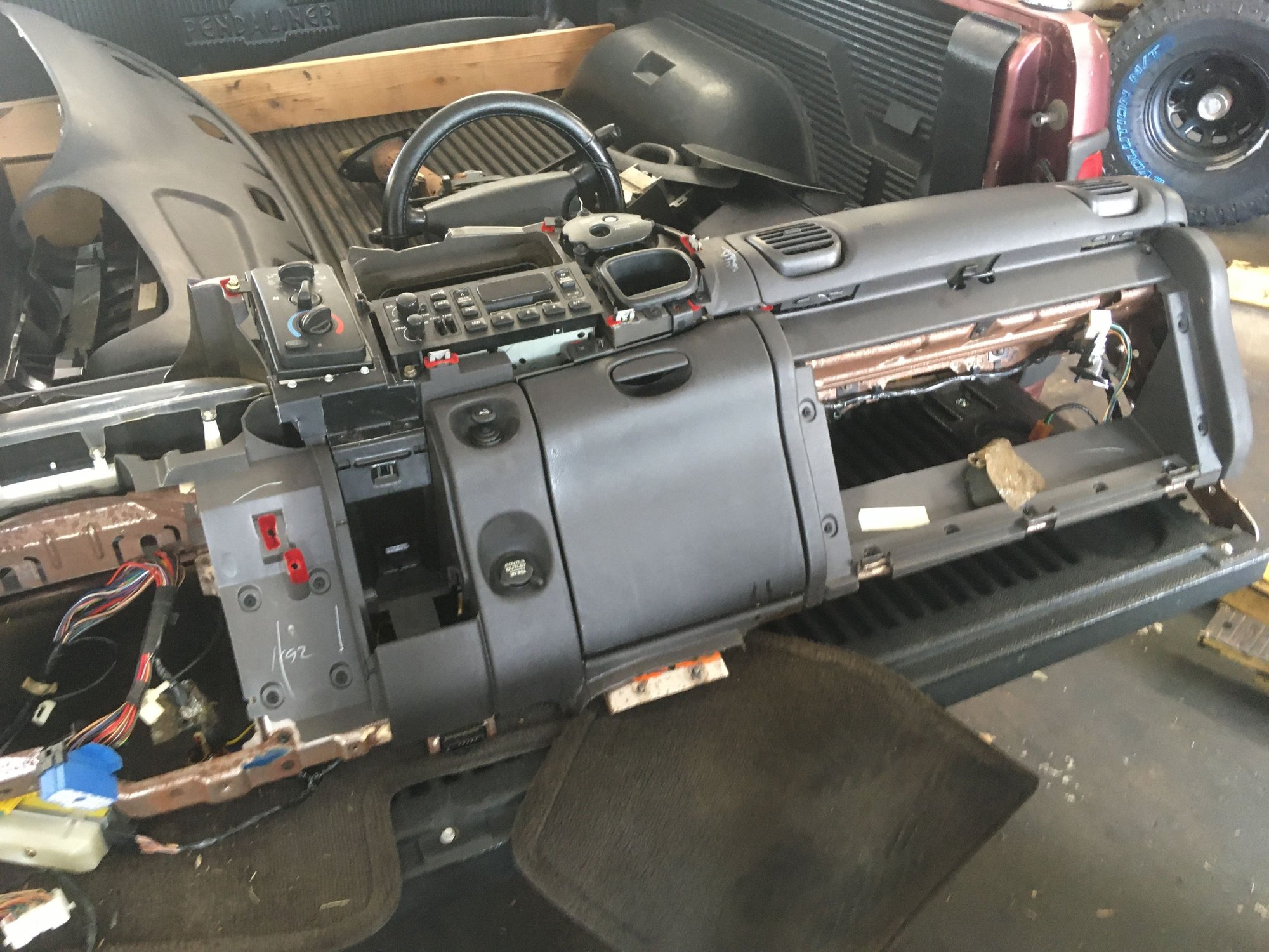

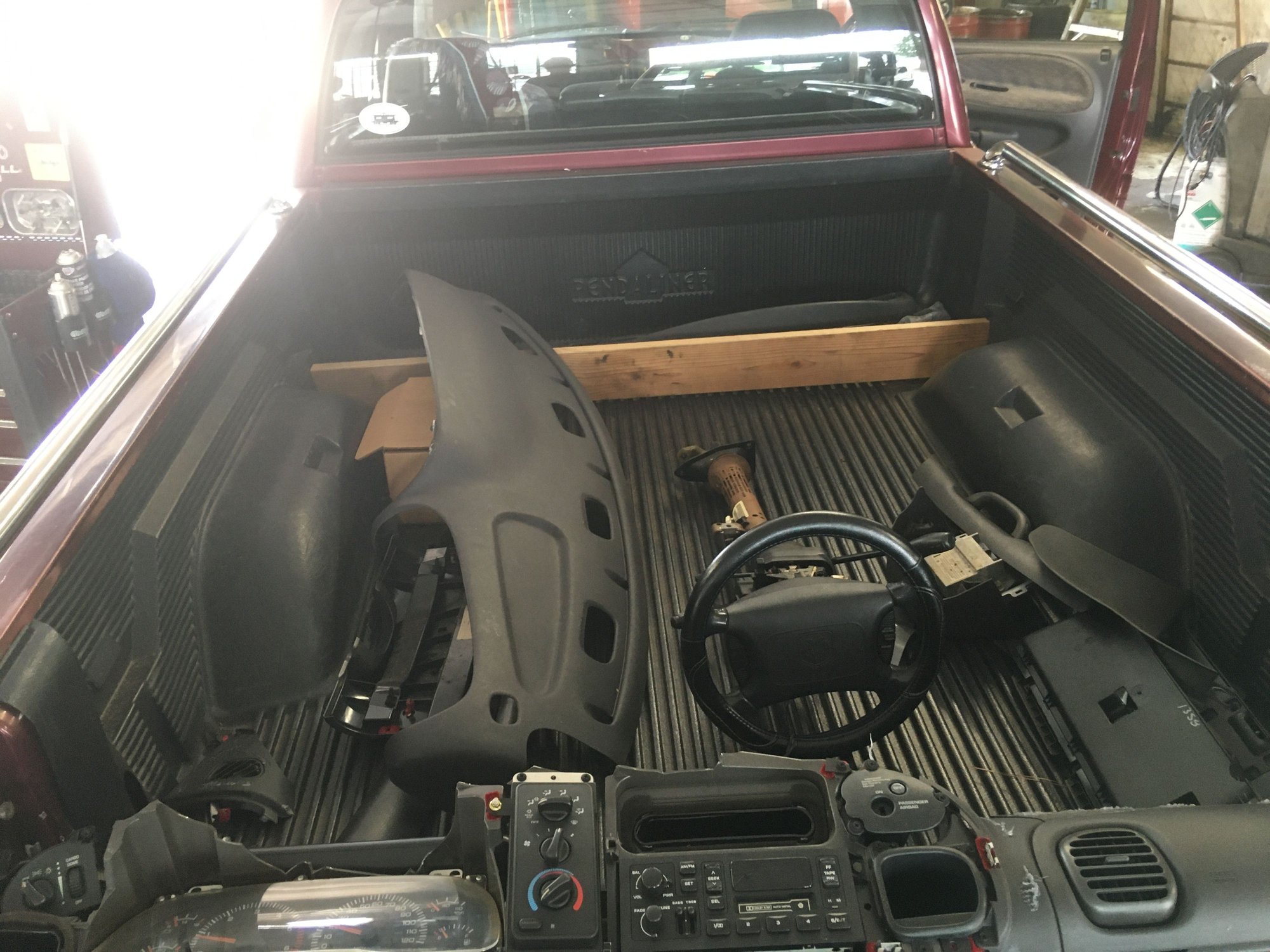

Took the truckster to a local independent shop on June 13 for freon recharge and front-end alignment. I had talked to them earlier about my intention to replace the busted dash pad and if I should have the AC fixed first. "Yes, because if the evaporator needs to be replaced, we have to remove the dash anyway." Short of mechanics/technicians so it was a couple of days before it could be looked at. I was called on the 15th with an estimate that included a new evaporator and dryer; I told them "while you're at it," replace the heater core too.
They called June 20, "bring us your dash pad." Since the dash assembly was out, I figured they are going to put it in as the dash is re-assembled. Tech called this morning, June 24, to say I have the wrong part, I need the glue-on cover. "Nope, the old broken cover is in the bed and I brought you a new pad." I got the receipt, printed pages from the LMC catalog showing the glue-ons and the new dash pad, made copies of of the emails I wrote to LMC to verify what I wanted to order and headed for the shop where I had a discussion with the tech.
Upon returning home, I called LMC and politely vented my frustration. I went back to the shop and talked to the tech who had prepared the estimate. He said I did have the correct part, but didn't think there was enough of the underlying structure to attach the pad to.
"I understand your reluctance to risk damaging a customer-supplied part and having to eat the cost. If you feel confident that you can install it without much problem, fine. If you don't want to risk it, re-assemble the dash without the pad and I will get my neighbor who I have already lined up to do it."

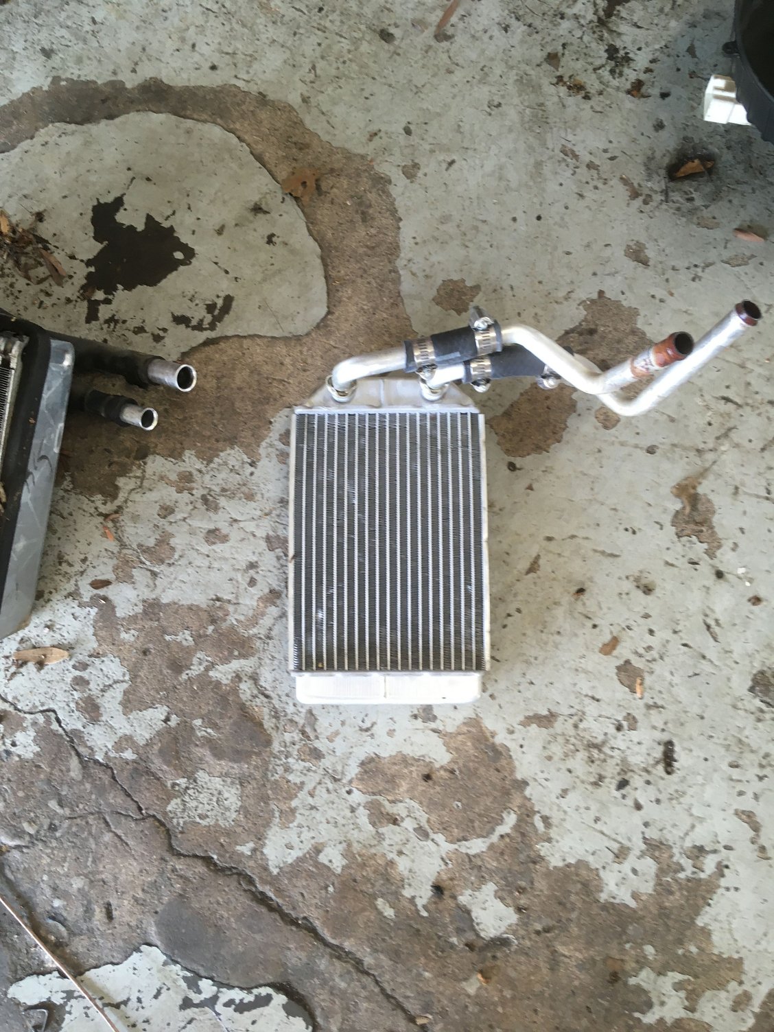

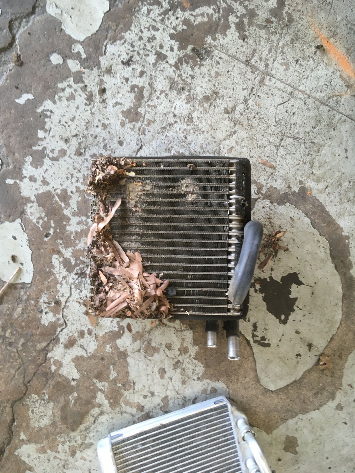

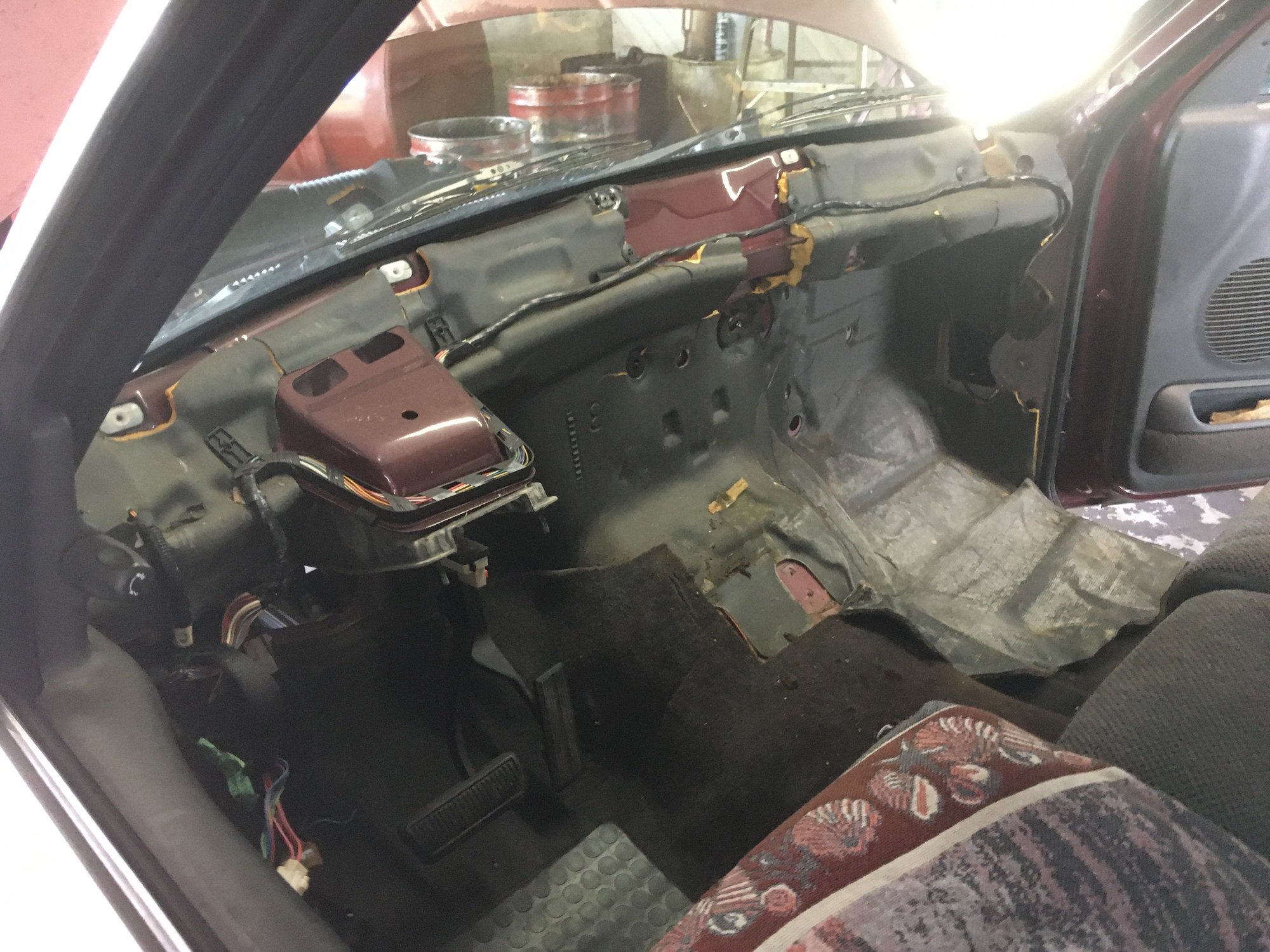

That's where it stands now. Pics of old evaporator and heater core with its cut & hosed lines attached.
Leaves blocking evaporator

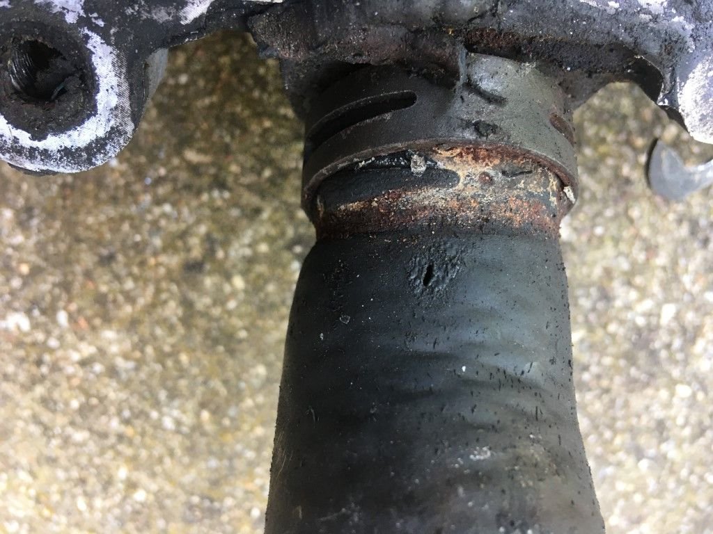

"Hosed" heater core lines. No wonder they wiggled around. But it wasn't leaking.
Parts piled in bed, along with new dash pad.
Dash assembly.
