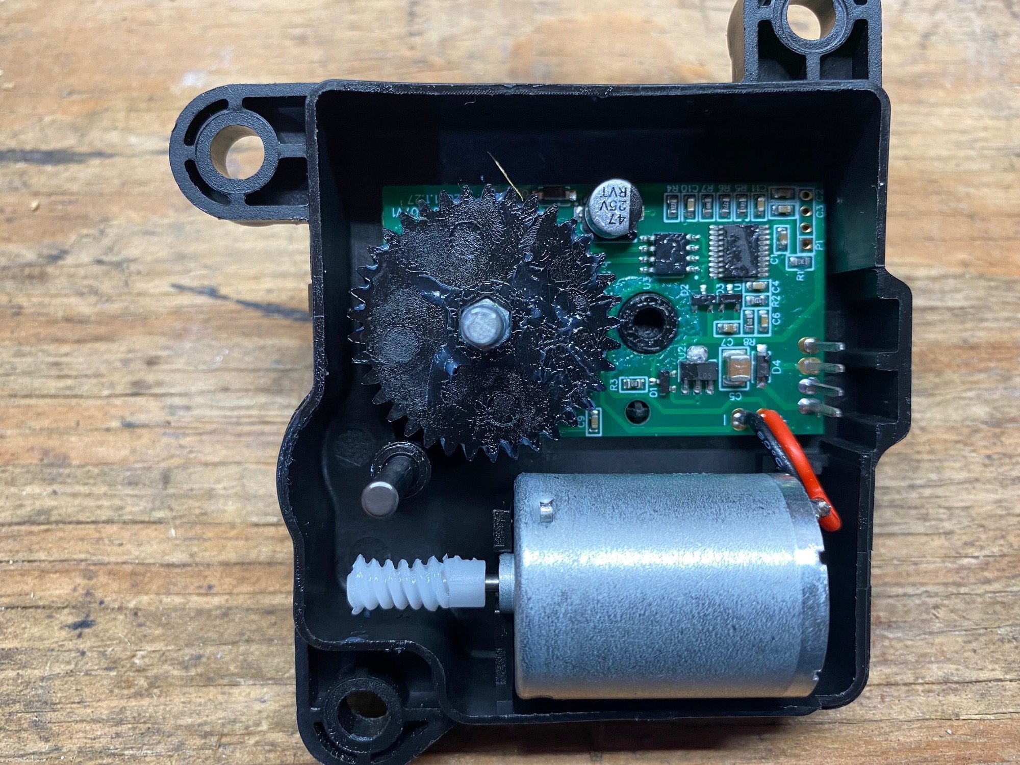

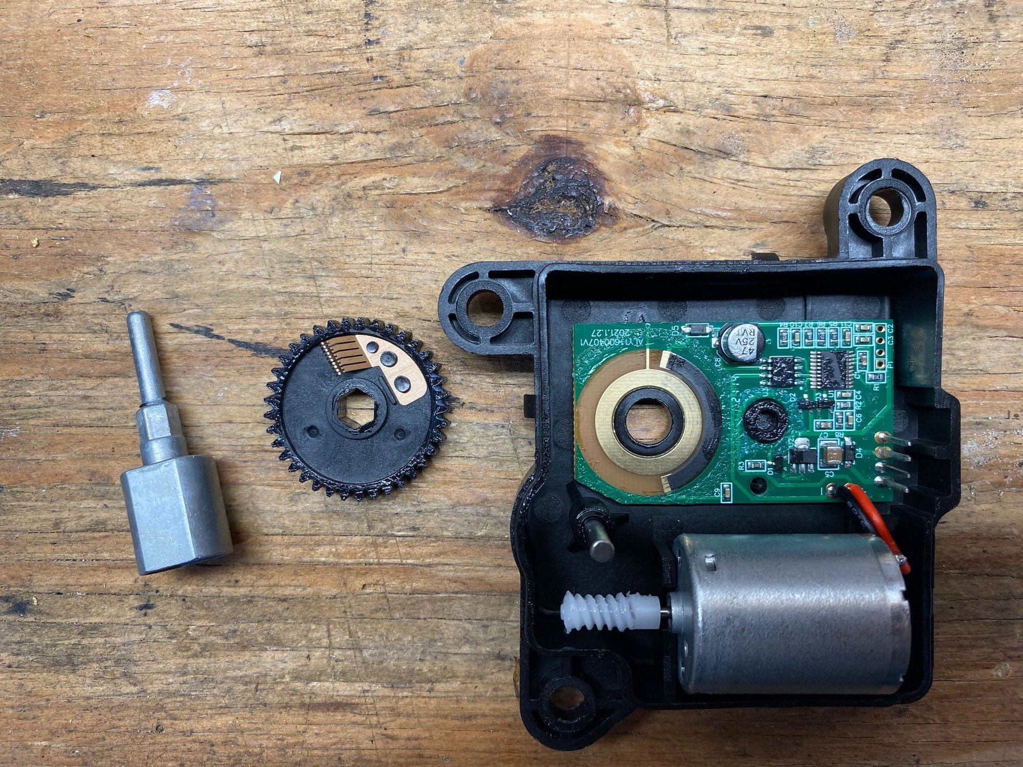

I don't see anything in the service manual about reindexing the motor. I'm not sure if this part has that. I took it apart and it uses some kind of sweeper to find out where it is in position to the resistance value. I'm not sure if that is how the old one works (I threw it away already). Below is a picture of it.
