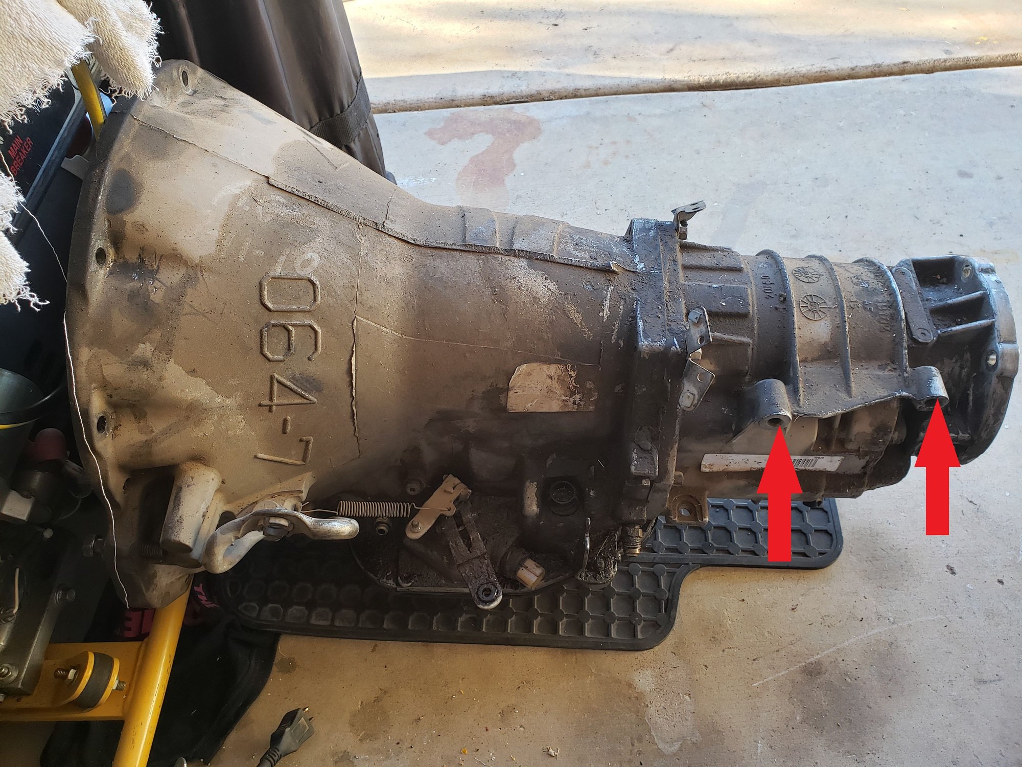

My donor truck was sold as 2001, but the manufacturing date is 04/2000.
4x4 shifter is in fact mounted to the floor, but it looks like there are screw bosses on the transmission OD housing that can hold the 4x4 shifter in my 1996 configuration.
Transmission has 3 plugs on in. 2 on the main body and one on the OD section (this would be the VSS sensor).
I will be using the transfer case that has the VSS sensor on it installed. So in the sense I have 2 VSS available for wiring, one on the transmission and one on the x-fer case.
I don't mind changing the wiring in the transmission, but I would rather avoid rewiring a whole truck with newer ECU, dashboard, etc. to control newer transmission.

I think the internal harness is part of the O/D and TCC solenoid set. So, replace ALL the internal electronics, and you should be golden. How the governor solenoid is held in is different as well.... not sure what you would need to do there.
Check and see if those holes are tapped. If they aren't, get a bottoming tap of the appropriate caliber, and have at it.

Nice to see that Dodge got lazy in the later years and left the transfer case shifter mount bosses on the overdrive housing.
